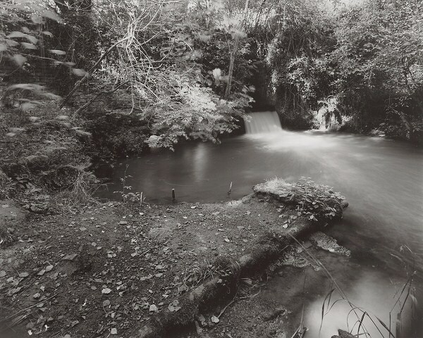

This was taken with the Fujnon 65mm and centre filter; if you view the image on its own, you may get a better appreciation of what 65mm looks like. Looking through the fence, it looks as though the centre is lighter, it is, but not because of the lens or graduated centre filter; that was how the light was.
Look at the sky across the top of the image, it is virtually constant across the entire frame; this is the graduated centre filter doing its magic.

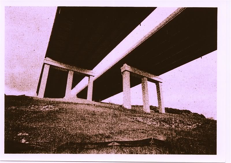

The below image is my 65mm lens using a graduated centre filter, the tripod is literally leaning into a steep sand dune, there is no way to get further away. The picture is slightly cropped on the left to remove the last trestle which was only half in the frame.
For those in Australia, it is the Kilcunda Trestle Bridge.
