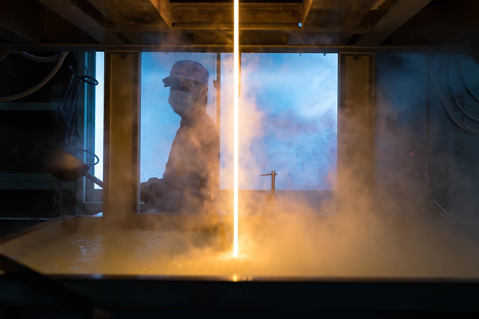

I found this. Hikari glass was started in the 1970s, it says here, but has only been wholly owned by Nikon since 2004.
..and another report of perhaps the same tour:
Elsewhere I found a reference to Japan buying large amounts of glass from Schott in the 30s.
