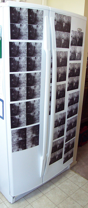

My "drying area" flat surface, in operation :smile:
In that case, I was using a proofing easel that aids in putting four 4" x 5" prints on a single 8" x 10" sheet.
One of these Saunders units:
https://www.ebay.ca/itm/Saunders-12...018559?hash=item33b41b46bf:g:23kAAOSwwpdW9ZW4
The description in that listing isn't correct about its intended use - but it is creative.
That's the first time I've seen a contour door Whirlpool SxS used in that fashion. I see you opted for the non-dispensing unit for more drying area.
That's doubly smart as most service problems are with dispenser. Now you need to try ferrotyping! :smile:.
