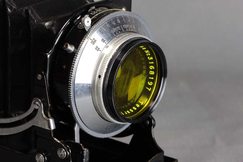

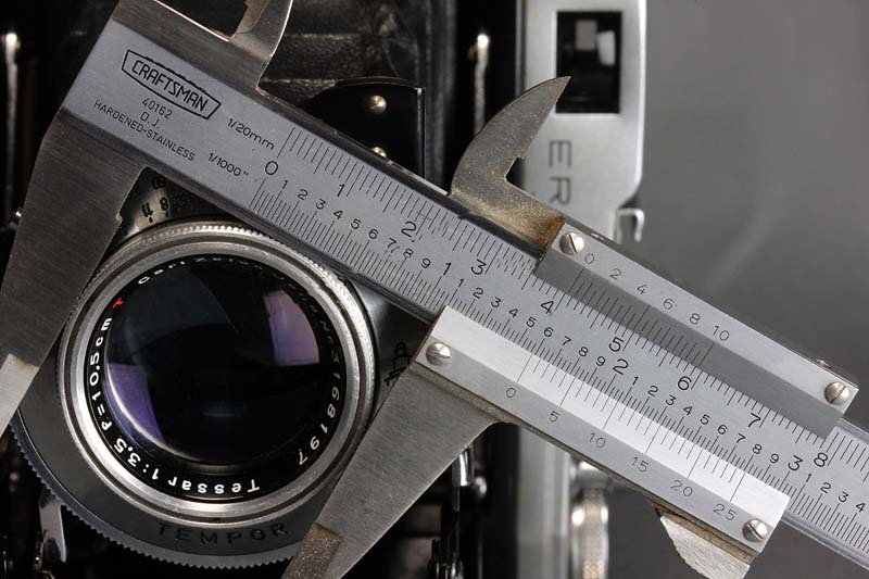

#10
Umm -- I have an Ercona II -- so all bets may be off, but 37mm filters slip into a groove in the front of the lens barrel. The outside of the barrel is about 40.3mm.
A Zeiss 37mm yellow filter installed:
(note it does not go over the knurling)
#11
Well their are exceptions and yours is one DW and thanks for the example. I was referring to lens with the smooth barrels.
