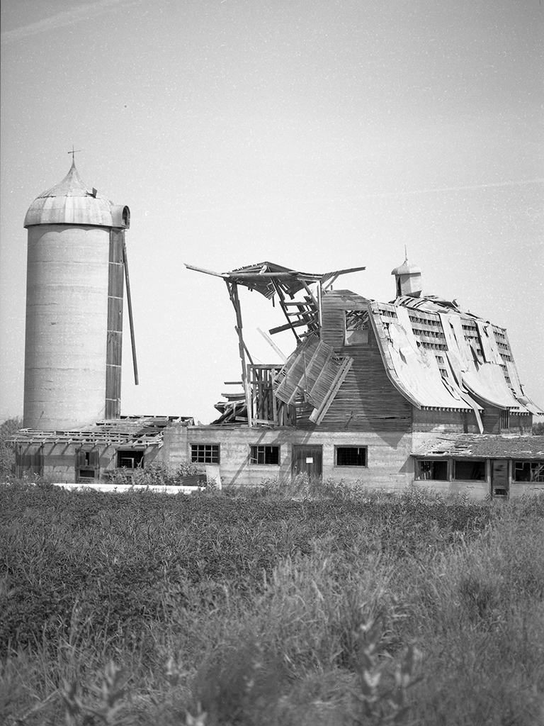

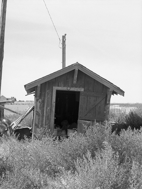

I was going to post these sooner, but life intervened in some dismaying ways lately. A violent thunderstorm tore down our back fence, the washing machine quit, and the weekend mass shootings all caused various forms of financial and emotional hardship. Regardless, here are two images using Rodinal as the developer. The first is 120 Ultrafine ISO 100, developed at 1:50. I exposed for the shadows in the shack, by the way. The second is 120 Pan-F+ 50, the film that provoked so much discussion here. I used Rodinal 1:50 for it too. I used the standard times listed in the Digitaltruth Massive Dev Chart. Except for cropping away the negative edges picked up by my scanner and downsizing them to the allowed site limits, both are unretouched. Zooming may cause pixelization: the shack is 96 ppi, I think, and the weird thing is 150. What is that thing, anyway?

Ken,
In the larger photo on the right I seem to be seeing a lot of small white dots in the sky areas. Is that on the negative?

Ken,
I think it's dust, Paul. Sometimes, no matter how careful I am, dust shows up in my scans. It might also be the result of downsizing the scan, because I didn't notice the dots when I looked at the scan in PS. Once I get through dealing with fences and washing machines, I'll take another look at it.
