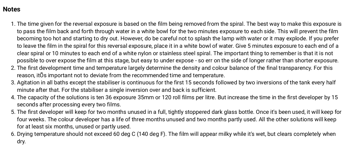

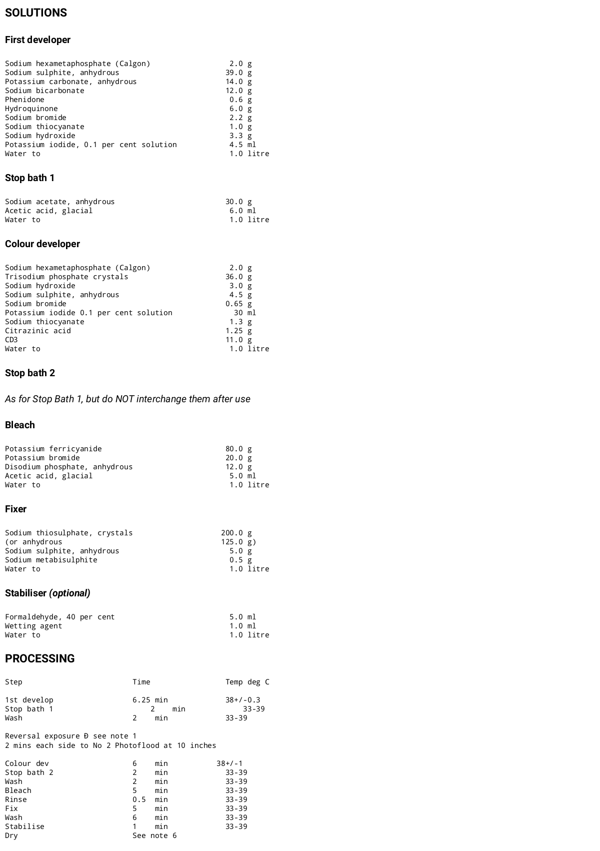

Try this :

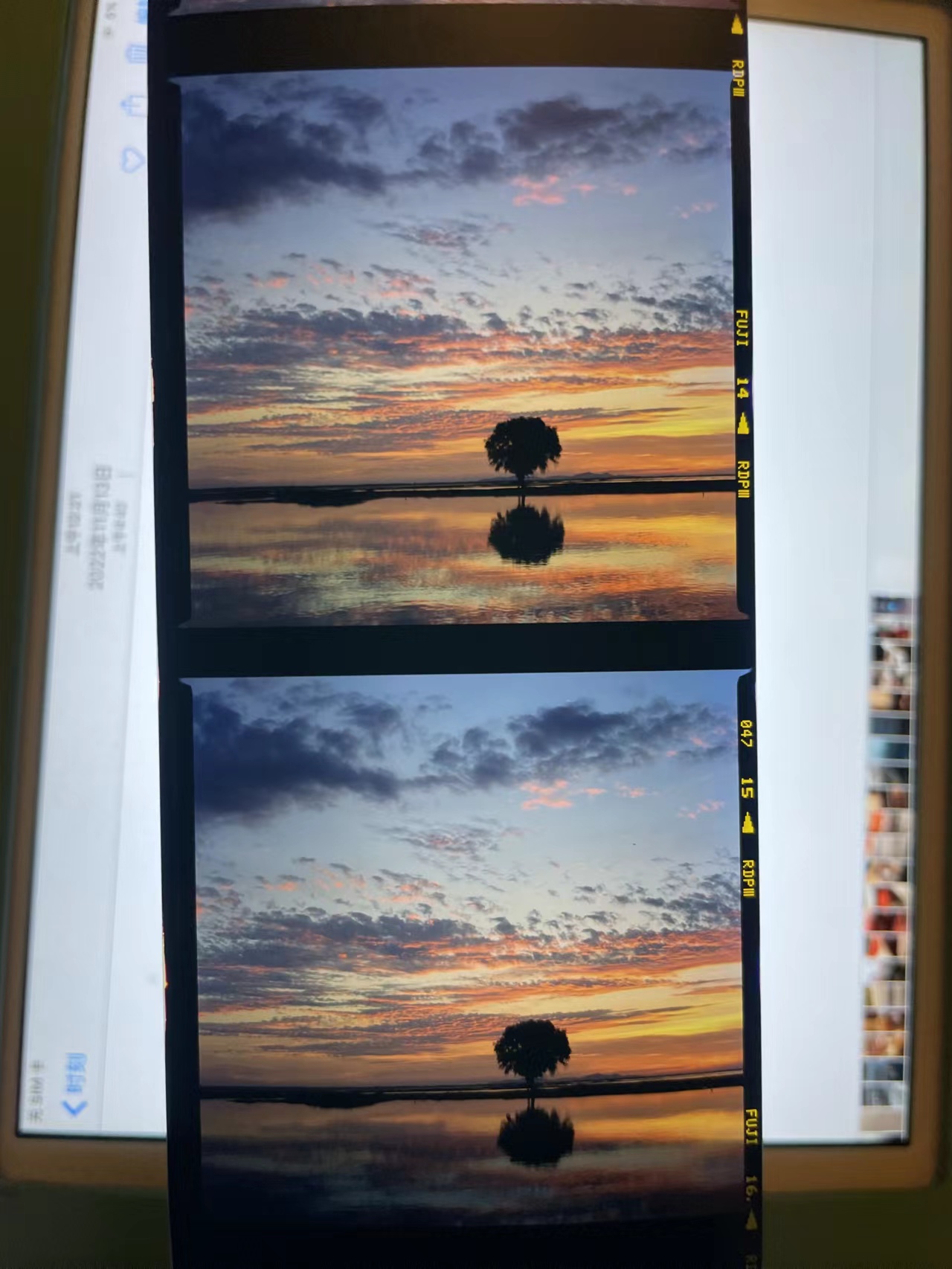

Hi all,just for update:smile:
Here are some processed by this patent formula.Got to say thanks a lot to Kodak!
And this formula is very expensive and hard to make too,still facing some issues
czygeorge
Dec 18, 2020
141
Beijing
