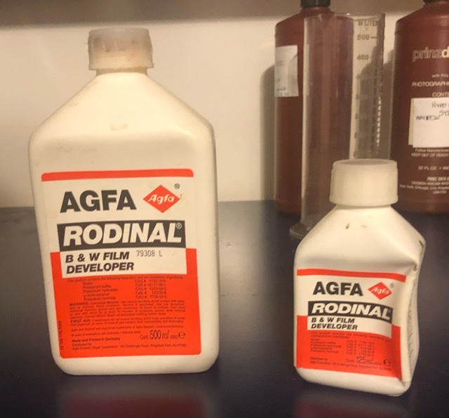

A friend gave me these bottles a few years ago. After reading this discussion I guess I should give them a try,
