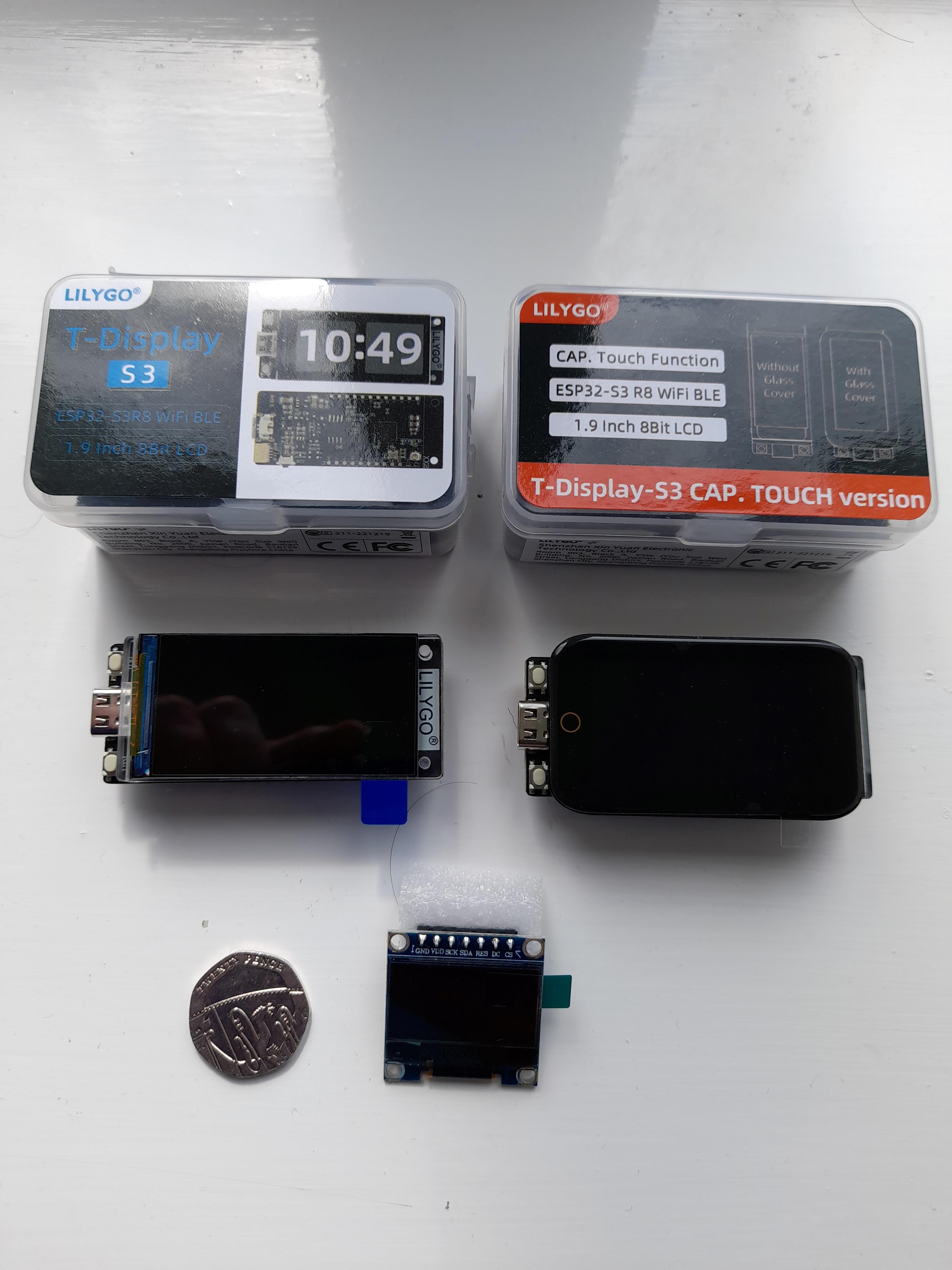

In other news, the light meter code is coming along nicely. A basic version is running on a Nano.
However it needs to be portable & battery powered, the simplest method would seem to be using a Lilygo T3-Display module. It is a development board (like the Nano) having a much faster processor, more memory, built in lcd screen and lipo battery connection & charger. The downside is of course, the price, over£20.
Just arrived are my lilygo boards & also a small oled display (which I think is too small for any practical purpose).

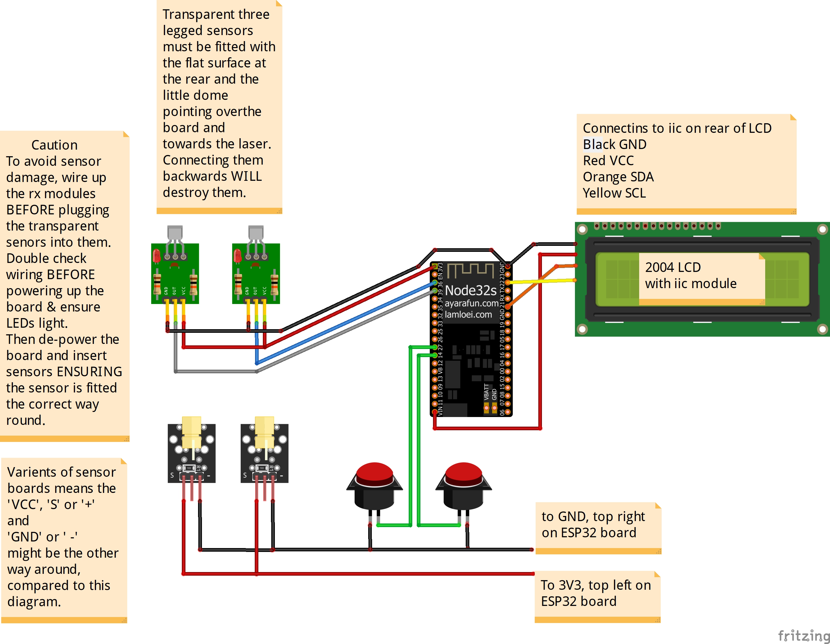

#7 Moving on from the Arduino Nano onto the ESP32 platform.
The Nano, whist working fine, is now so full that nothing else can be added.
The ESP32 is also much faster & the screen output can be raised from 115200 to much faster rates, allowing for an almost instant display.
Ideas for future improvement include shutter speed guessing, where the software will display what it thinks your camera speed dial is set to. (Camera needs to be reasonably accurate for this to work) and how far out your camera is. (This is actually almost finished)
Adding a setup routine, to check laser alignment & test if newer sensors are being used, which have the output reversed.
Adding a further two lasers at the edge of the gate & an input from the flash PC sync socket.. This will allow for full flash sync checking. This will be long term due to my lack of workshop t the moment.
There are numerous ESP32 development boards. Any should work. I am using the nodeMCU-32S which is the 38pin board. This goes well with the 38pin screw terminal breakout board. Cheap as chips from Aliexpress, but delivery can be weeks to months, depending on your order value. My last order (express air-mail due to price & type of goods) took four days from China to Royal Mail, who then took five days to deliver. Next post will have links to the development & breakout board.

#8
Below are links for all the parts required on the AITEXM ROBOT store on Aliexpress.
Buying from one store can get express shipping. Last time I ordered from this store & also the Lilygo store, got combined express shipping & parts arrived four days after order. Royal mail took a further five days to deliver :surprised:)
It is of course far quicker to order from a UK based Ebay or Amazon shop, but prices will be higher.
KY-008 laser
Laser rx
LCD - Ensure to select LCD2004+I2C
Push-button. Mounted on board, so no soldering required. 2 needed. Cheaper options if you can solder.
Dupont wires - get the 30cm male to female ones.
ESP32 development board & breakout board - Ensure to select last item Type C ESP32 board & breakout board.

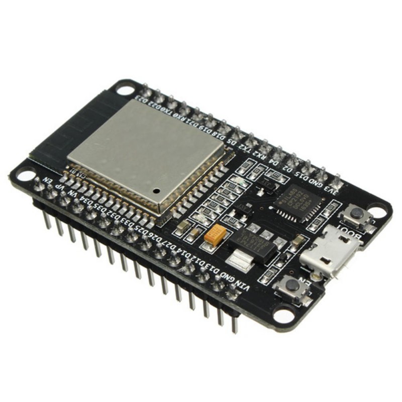

Is either one of these boards ok?
I'm trying to buy locally (hate waiting for things from aliexpress) and I have absolutely no idea what I'm doing :D
I've built a shutter tester before (single LED, arduino) but in a 'monkey sees, monkey does' fashion so I'd rather ask a stupid question than see the magic smoke escape my components.
Thank you!

The ESP8266 has relatively few GPIO pins for truly generic use. I haven't done a pin count on this project, but I think it's going to be a borderline case. So I'd drop the first board in favor of the second.
Keep in mind that all ESP boards are 3.3V logic, so their GPIO pins are also only rated for that voltage.
