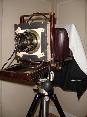

Mark,
You might want to consider a "Packard box" with your 2D if you want to use multiple fast barrel lenses. I use a 12" F3.5 Dallmeyer Portrait lens, Heliar 36cm and 42cm lenses with this setup. Very happy with my results.
Hugo
