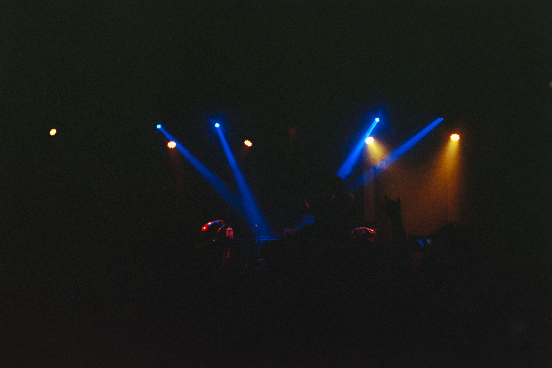

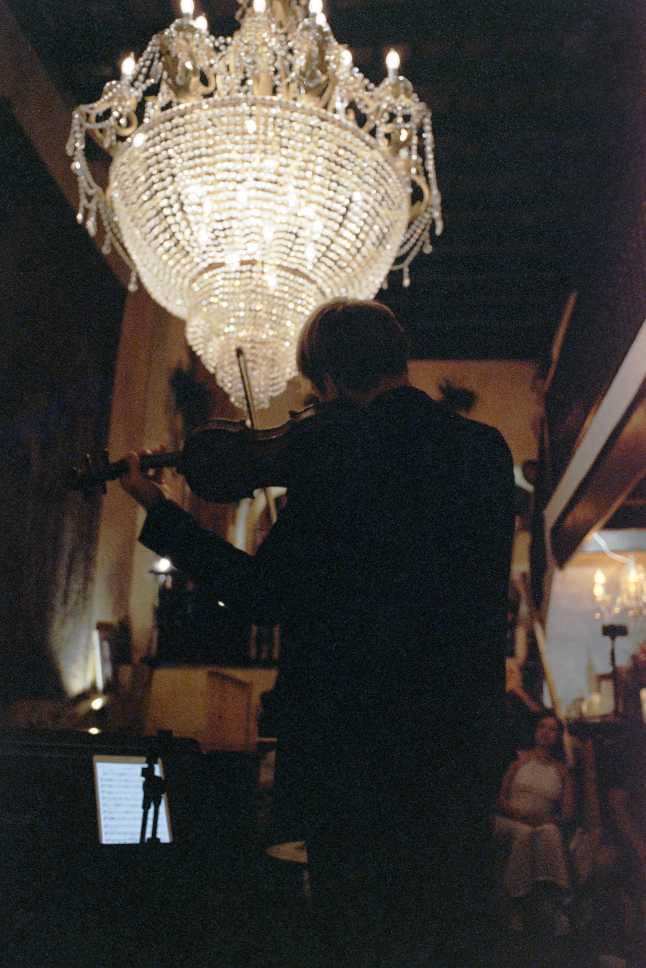

After developing 18 rolls yesterday (12 c-41, 6 ECN-2) I can conclude that the issue with developer/bleach crossover causing staining to be entirely resolved. At least as far as I can perceive it.
The culprit? Probably just insufficient washing. The only variable I changed yesterday was to add a 5th wash cycle after developer/bleach and up the stop bath to 250ml 5% white vinegar/750 water (1.25%).
There may have been a chemical issue also at play here, but I think that the most simple answer is likely the correct one.
Just wash more!!!
I also ignored the sodium sulfite clearing bath post bleach. Using 40g of SS each dev seemed like overkill. Additionally, I should mention a liter of TF-5 cleared 18 rolls of CN satisfactorily @6min fix.
Now I can focus on the other (various!) inaccuracies and undesirable imperfections in my processing. Thanks for the help, this has all been very informative.
