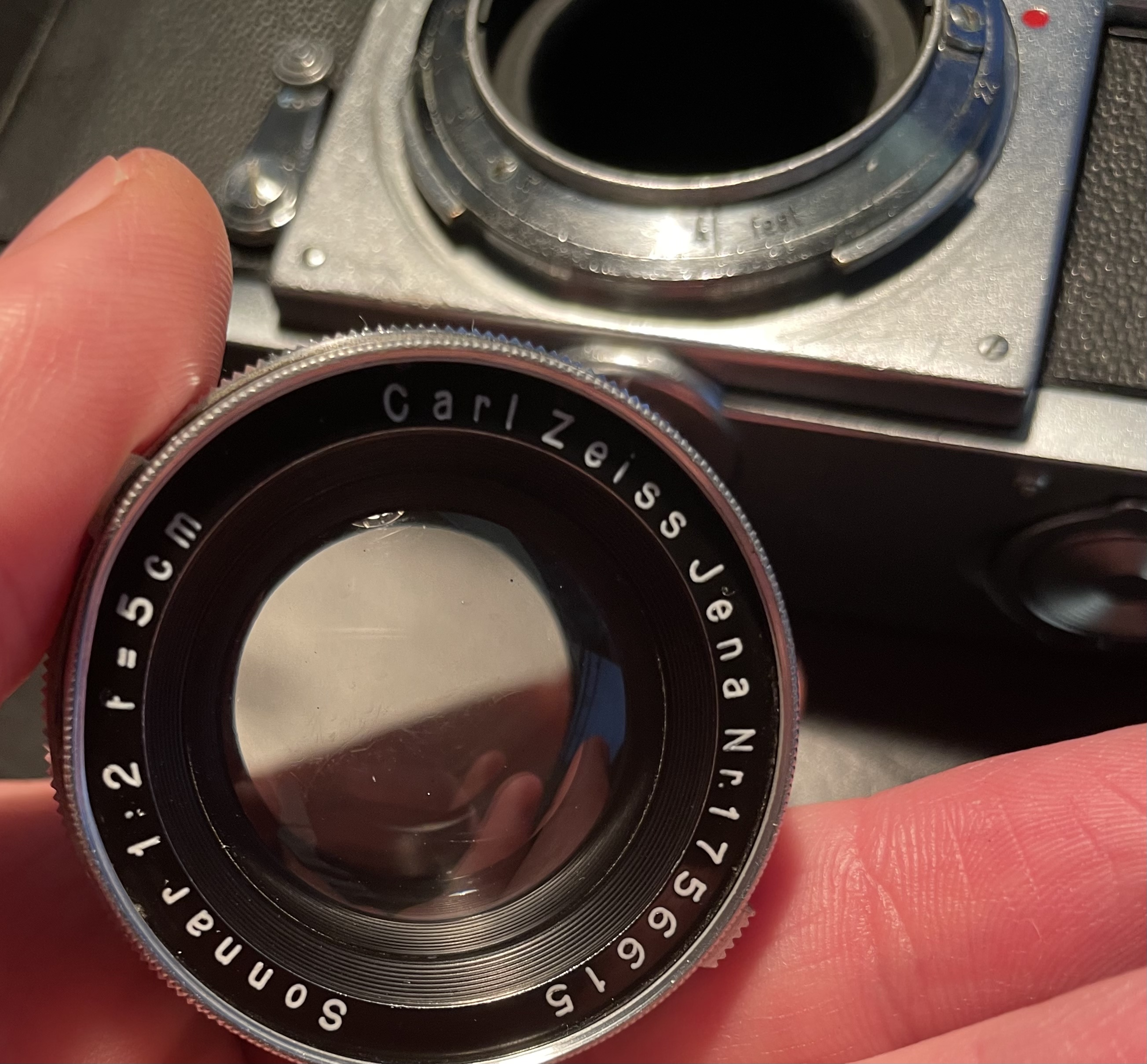

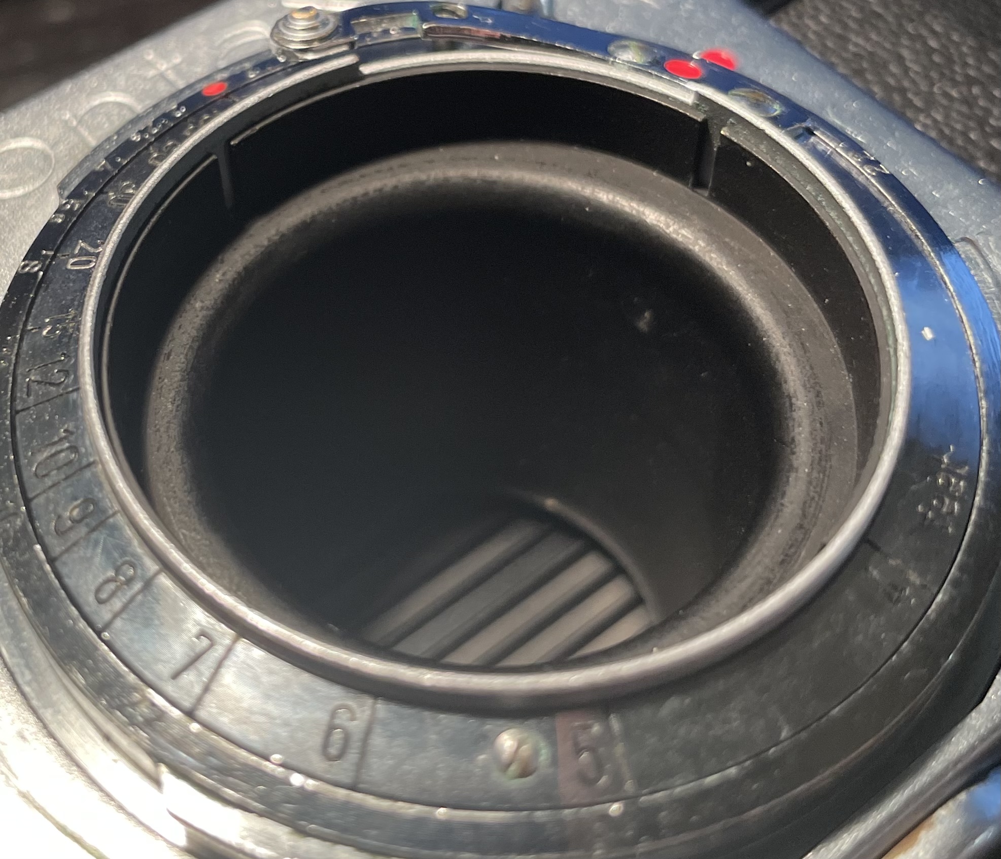

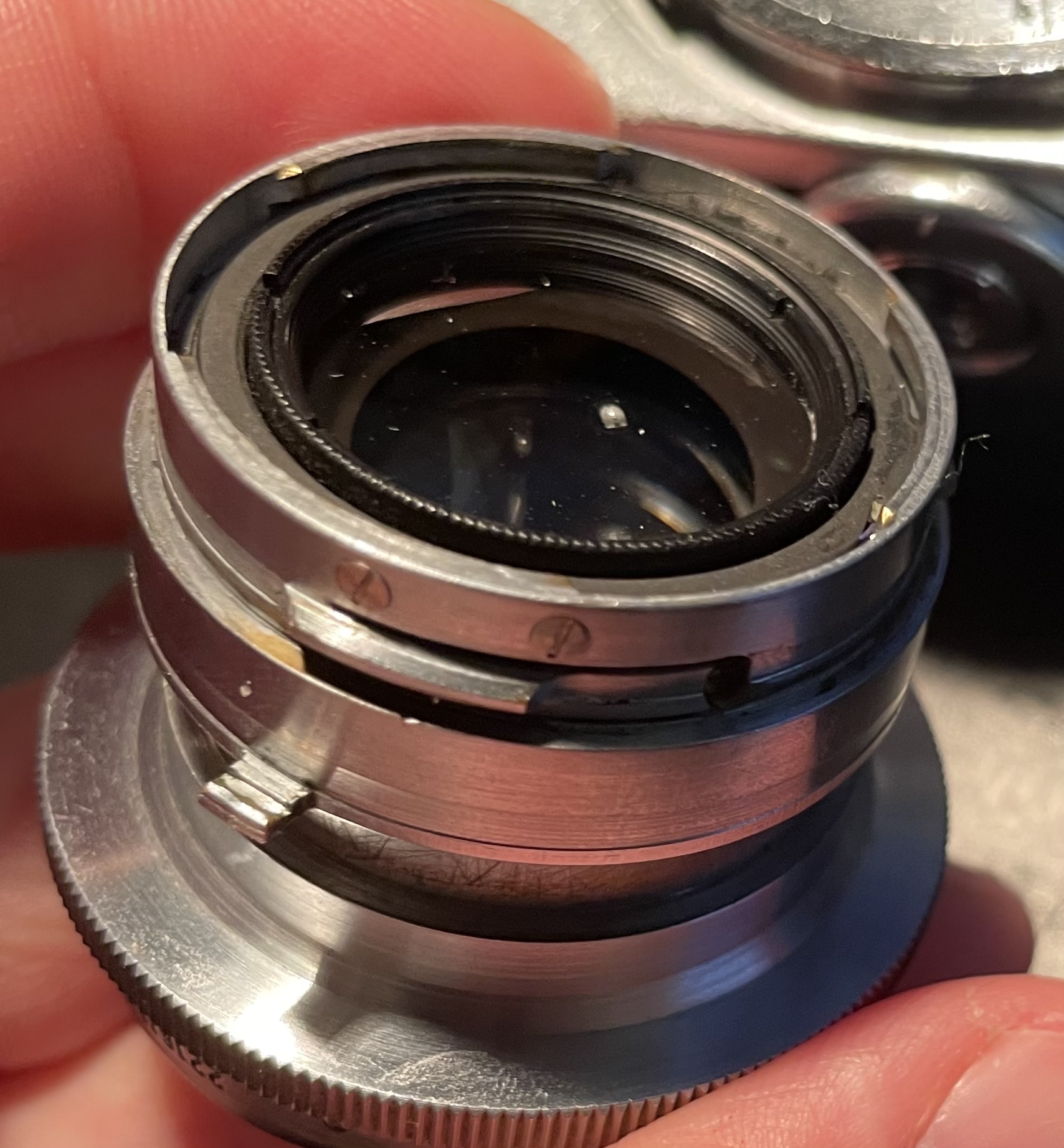

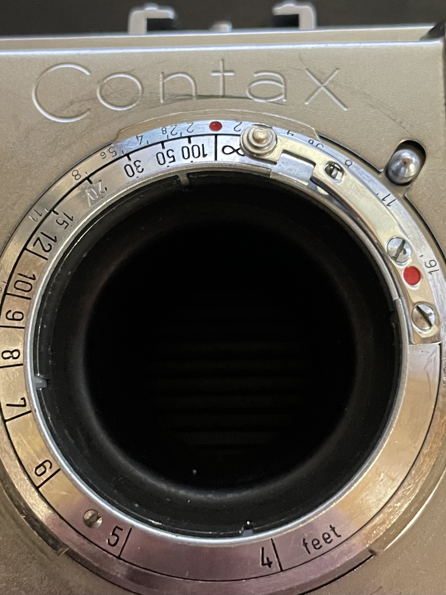

Hi all! Hope this forum is still somewhat active. I just inherited this old Contax (I believe it is a iia) and ordered a Carl Zeiss Sonnar f2 Jena for it in Contax RF mount. I tried to attach photos of the camera and the lens, but the photos were to big. My trouble is with the black plastic/metal piece inside, which covers up where the internal bayonet mount is. I'm not sure if this piece can be taken out (and if so, how?), or if this is a variant of the camera? I've tried to find other cases of this particular piece in other Contax iia's, and haven't found anything.
Any help would be very much appreciated!
Reduce your picture size to no more than 1000px's in any direction and try posting them again, it will be the best way to get help.
@Neil Morgan let me know if those photos are clear and helpful! Anybody know what that black smooth metal cover between the focus ring and the shutter is? Haven’t seen it on any other contax ii’s
Thanks for any help all!

That does not look right. It appears you have something in there that does not belong. You should be able to see the bayonet inside (three pieces of metal in the mount around the inside of the hole). I'll see if I can upload a picture. Does that black piece that extends back to the shutter move at all? I wonder if someone tried to tinker with it and got something stuck.

Not sure what the insert is but you need to remove. Lens normally comes off by turning clockwise. You may have to take the back off fire in bulb and hold the shutter open while you push it out from the inside.
