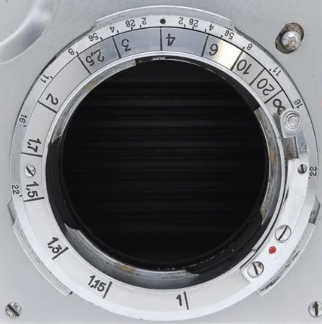

That is different. I am certainly not an expert but have and use several Zeiss Contax IIa and II cameras as well as various Russian Kievs and have never seen anything like that. Send that picture to Mark Hansen at ZeissIkonRolleiRepair.com and see if he has any ideas.

@Neil Morgan let me know if those photos are clear and helpful! Anybody know what that black smooth metal cover between the focus ring and the shutter is? Haven’t seen it on any other contax ii’s
Thanks for any help all!
That thing needs to come out. I don’t know what it is. Guess it’s an attachment for microscope, telescope or binocular. You will want to remove it to attach a normal lens.

Thanks all. I tentatively tried the bulb method a while back but didn’t want too push to hard. After hearing y’all’s feedback, I felt a little more confident. I have a press with both thumbs and voila! It popped out! Thanks so much everyone! Excited to start shooting!
