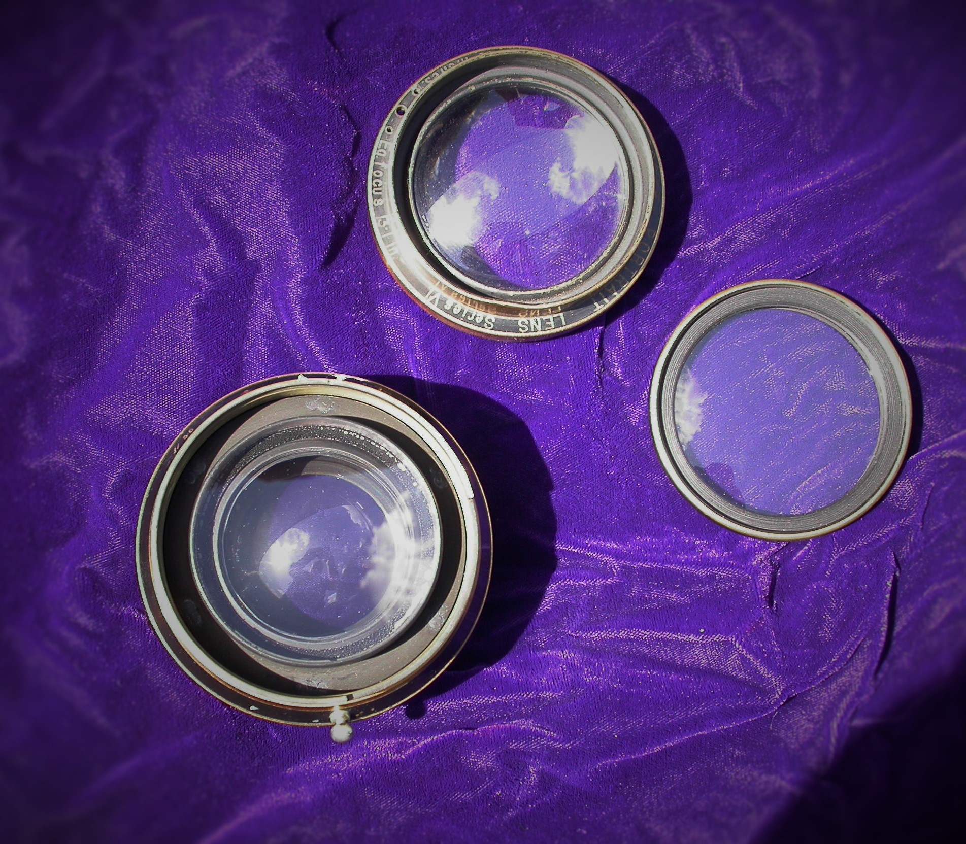

Here are some pics...

13 inch focus for 9 x 7 inch in 1931.
Same design as the IIa I worked on but the IIa does not have variable soft focus.
Center element appears bonded in place.
Yeah, that seems right. I might have to VERY CAREFULLY and SLOWLY use a solvent at the lowest edges of the aperture mechanism and drain carefully. I just worry about the glass and cement on that center glass.
