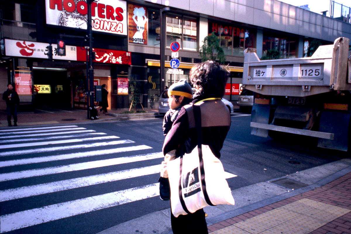

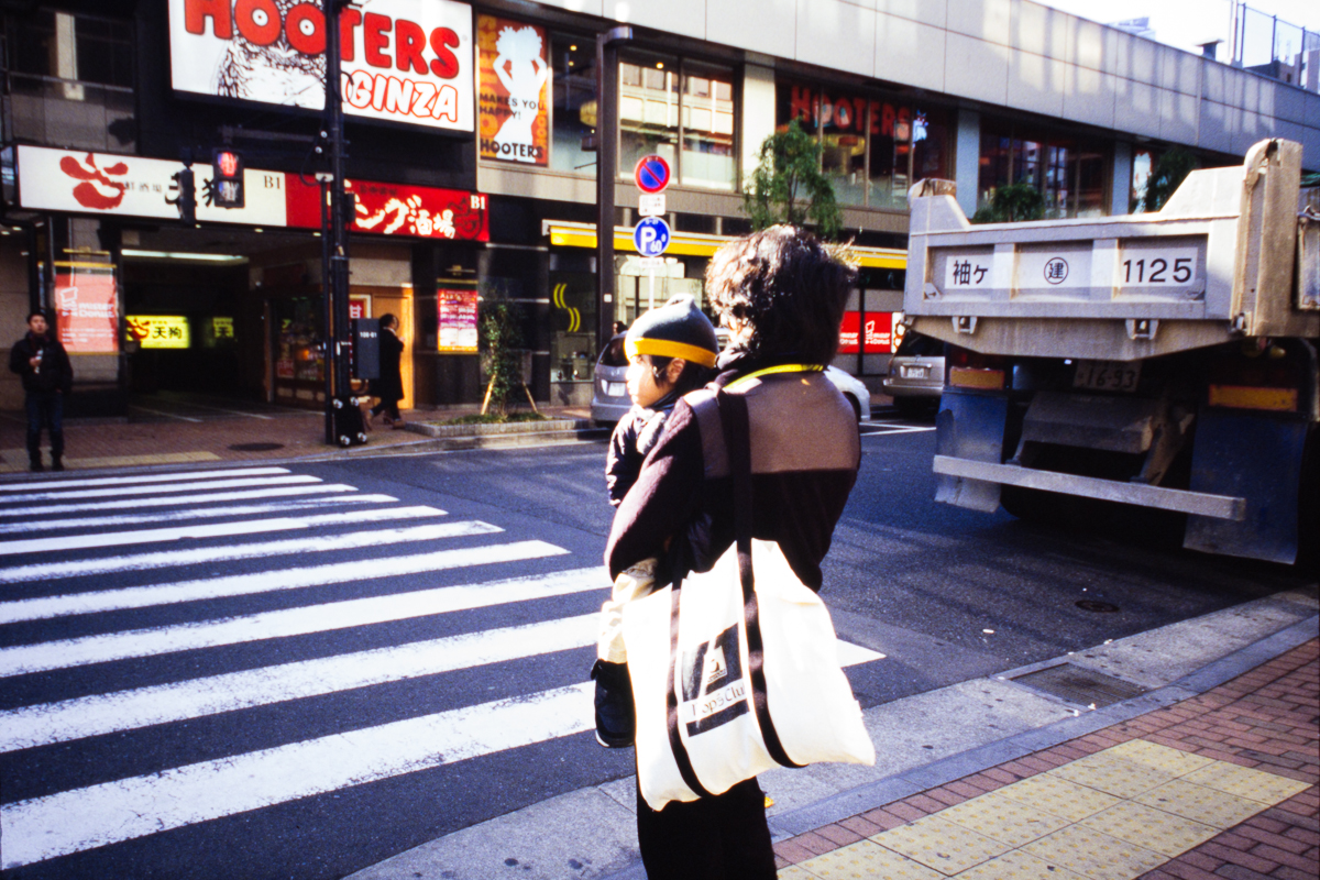

I just tried scanning two pro via 400x photos. One with custom white balance based on the light table and one with an IT8 calibrated profile.
I think I like the custom white balance better.

Eric, you're welcome. The Provia scan looks pretty good, but the white tote bag appears to be blown out. Was that on the slide, or is it a scanning artifact? I often have trouble getting the right highlight level without either losing the shadow detail or blowing out the highlights to bring up the shadows, hence the thinking about HDR. Dedicated film scanners do a multi-pass multi-exposure scan to get to their rated Dmax, which probably means HDR for DSLR scans.

The blown out tote bag is the sort of issue I seem to encounter when trying to use an IT8 target (you can see more detail in the custom white balanced shot). I've always assumed it's been either my scanner software or technique, but I've seen similar results from many different workflows. I eventually decided it wasn't worth the effort to get scanner profiles working.

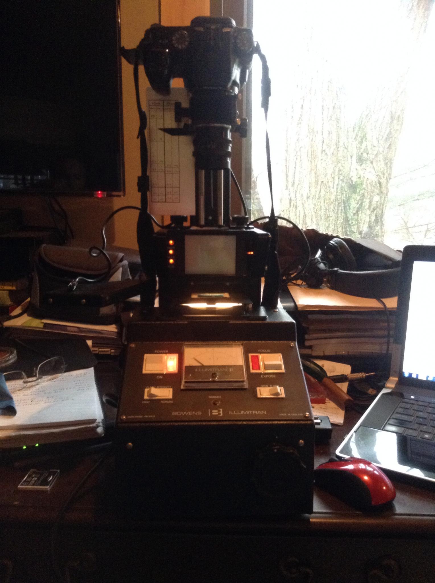

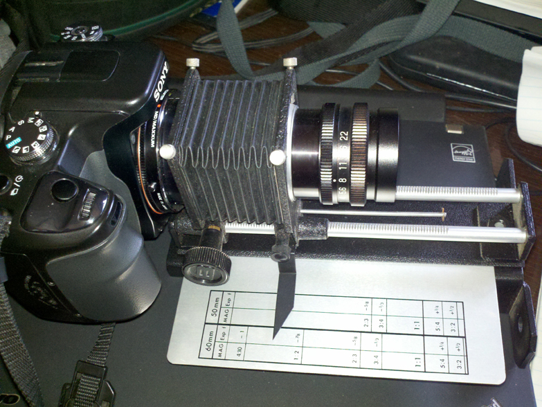

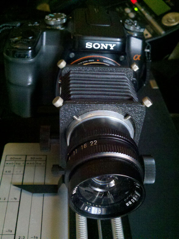

I use a Bowens Illumitran to digitize 35mm slides and negatives
I digitize 35mm slides and negatives with a Bowens Illumitran. I already had a Minolta MD body mount for the Illumitran, so I purchased a Sony Alpha to Minolta MD adapter. This allowed me to attach my Alpha body to the Illumitran bellows. As far as lenses go I can use any enlarging lens that I want as long as it fits the Illumitran lens holder. For 35mm copying I have been using a Bogen 60mm or a Rodenstock 60mm. Both are recommended copy lenses for the Illumitran. I also have an attachment for copying up to 4x5 negatives with the Illumitran. I haven't tried copying 4x5 yet. Here's a pic of my Alpha body attached to the Illumitran bellows assembly. The bellows assembly is removable so I sometimes use it as a a macro setup.
