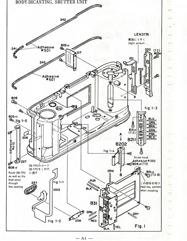

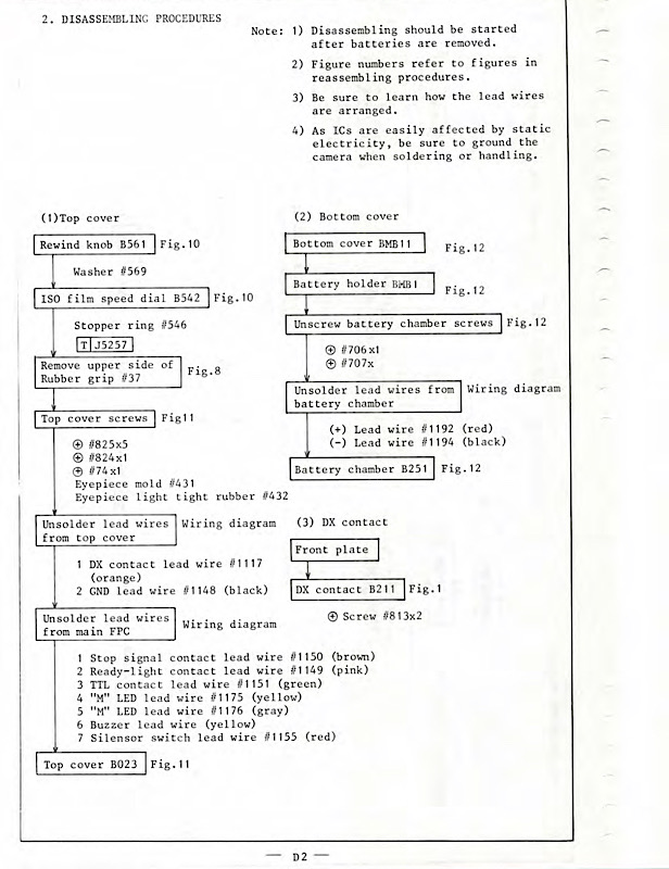

There will be a lot of work to do before I reach the damaged shutter.
Removing the top cover with mountings, the base plate, the front panel, and desoldering some cables.

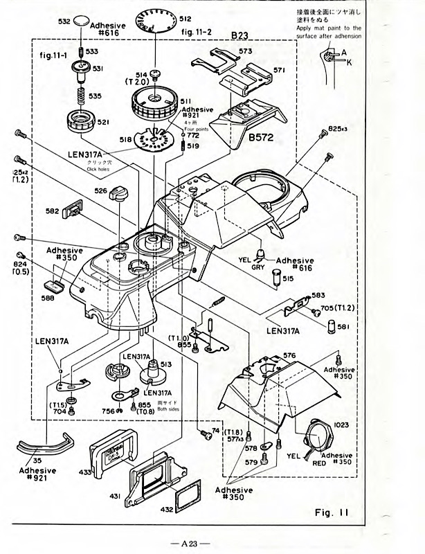

Here from the repair manual:
The shutter seems to be quite simply assembled, but there is a some electronics connected to it.

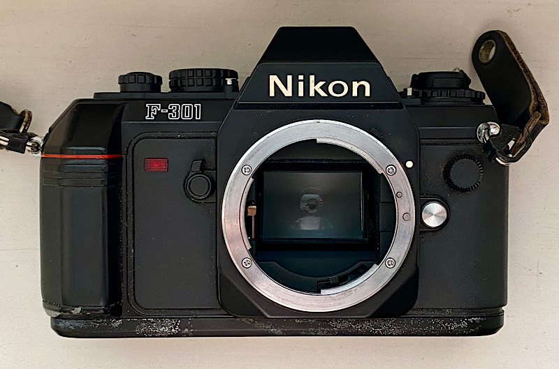

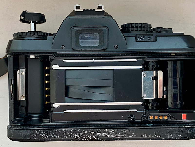

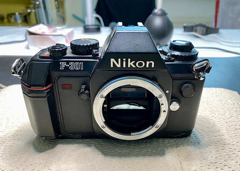

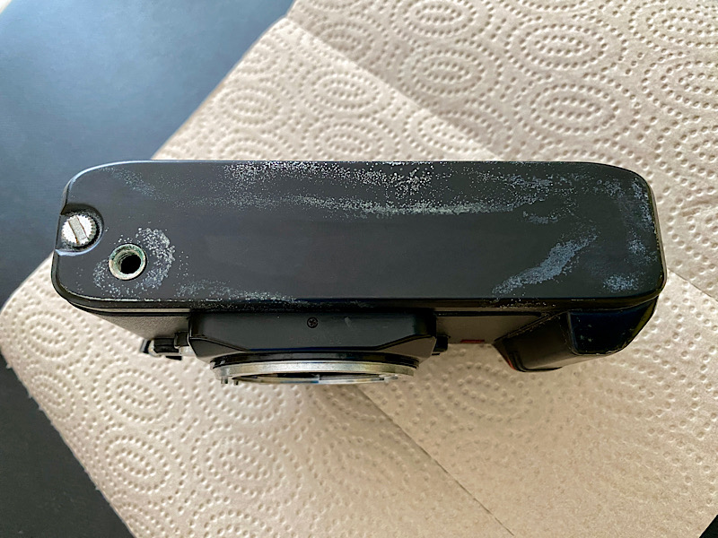

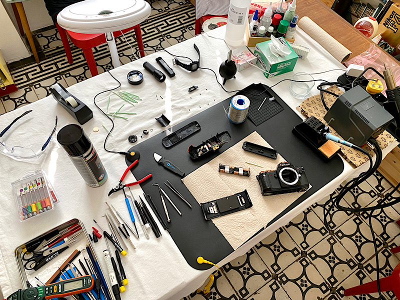

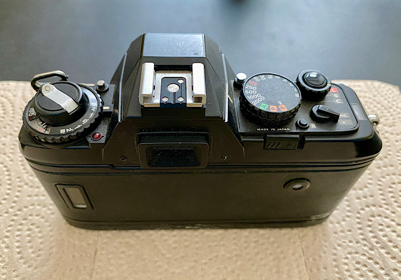

First check

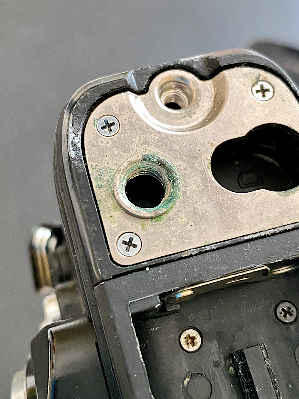

The external condition is acceptable.
Are there obvious signs of chemical treatment on the metal base plate?

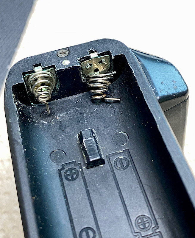

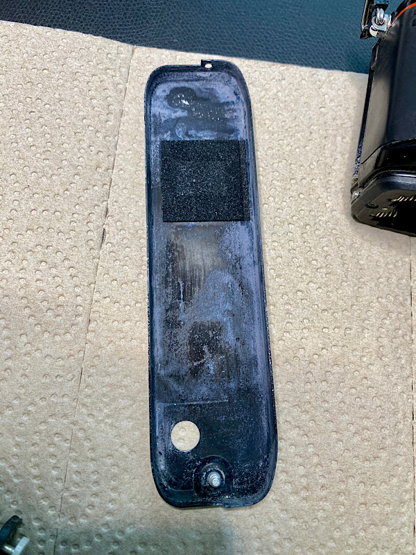

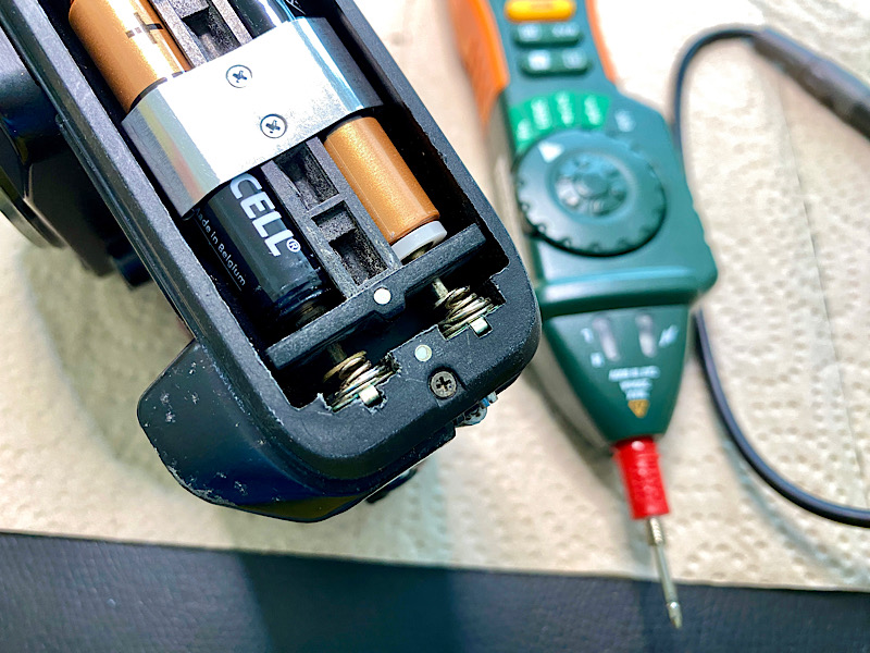

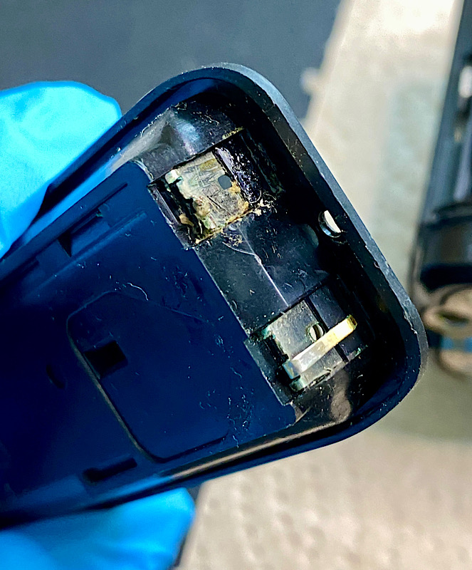

Remains of leaked battery acid in the battery compartment.
The contacts of the battery holder (not shown in the picture) are also affected.
I don't know what happened here.
The contact spring has fallen out of its retaining tabs. This can be fixed.
Corrosion caused by battery acid can also be seen here.
The tripod connection is also corroded.

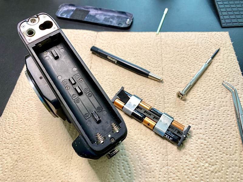

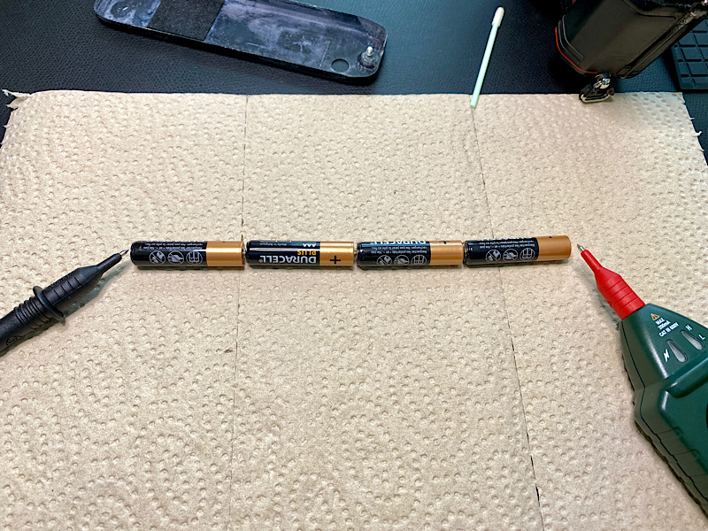

Check the power supply (4 x AAA batteries = 6 volts)
I don't measure any voltage on the two pairs of batteries, each connected in series.
I clean the contacts with the fiber glass pen.
The multimeter now shows 3.1 volts in each case.
This means that the contacts are now conducting.
A measurement across the battery holder from minus to plus shows no voltage.
But the camera needs a 6 volt supply voltage?
I measure the batteries directly in series: 6.2 volts.
That's how it should be.
Also in the battery holder.

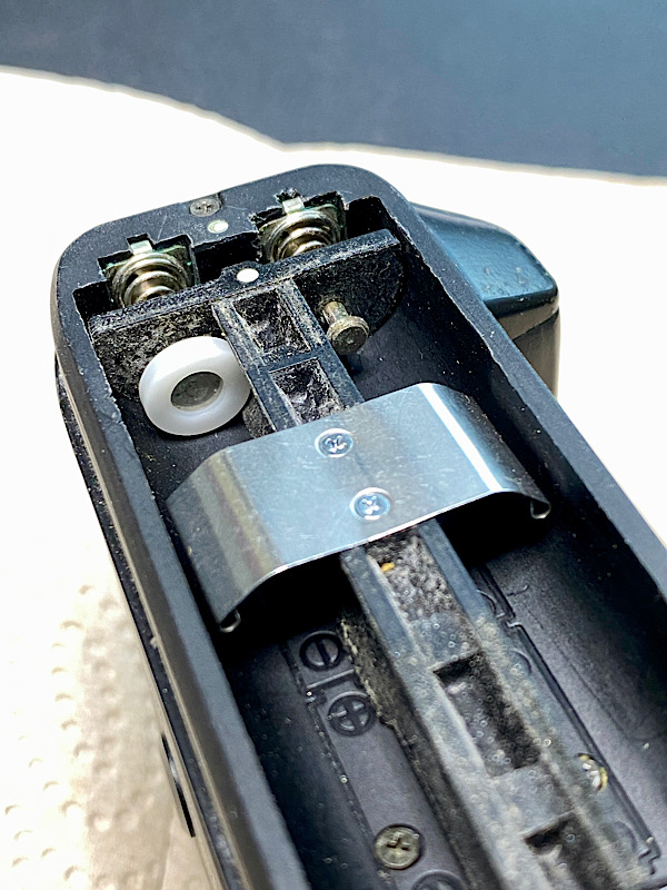

But how is it wired?
The battery compartment provides the answer:
A contact bridge is installed here so that all four AAA batteries in series add up to 6 volts.
That's why I couldn't measure the total voltage in the battery holder. The two pairs of batteries were not electrically connected to each other.
The battery holder is inserted into the battery compartment.
I don't measure any voltage on the two contact springs, so I still have to clean the contacts in between with the fiber glass pen.
Now I'm measuring 6.2 volts on the two contacts that connect the circuit to the battery voltage.
So my cleaning of the battery compartment and the battery holder was successful.
But no LEDs light up in the viewfinder when I press the shutter button.
So there are either further problems with the power supply inside the camera or a problem in the circuit.
Hopefully I'll figure it out.

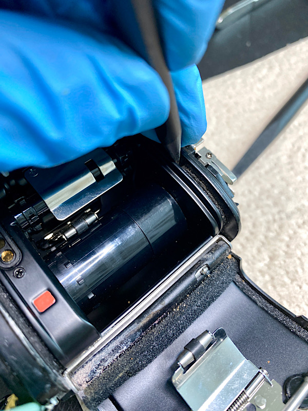

Dismantling the top cover

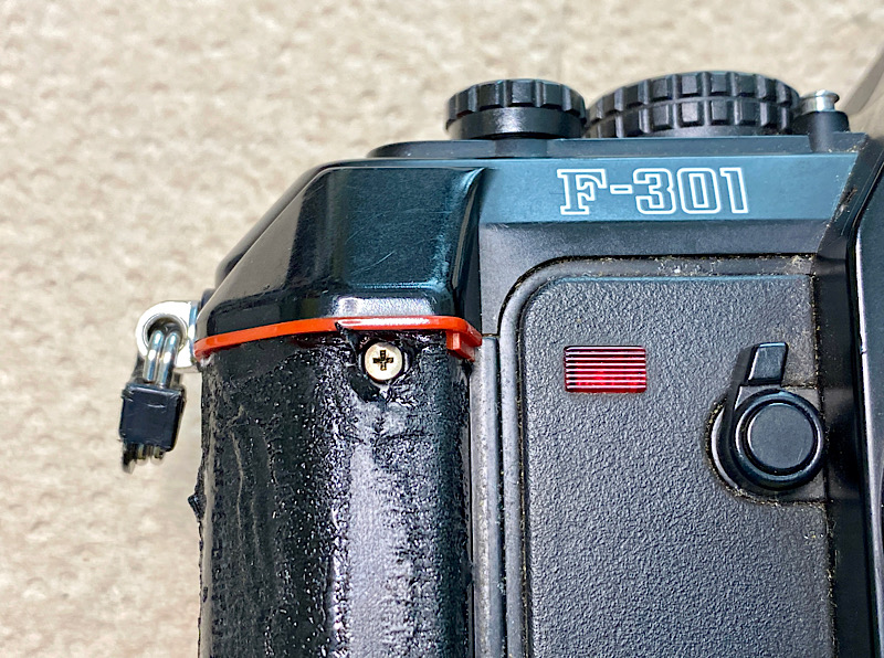

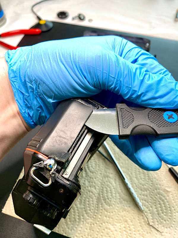

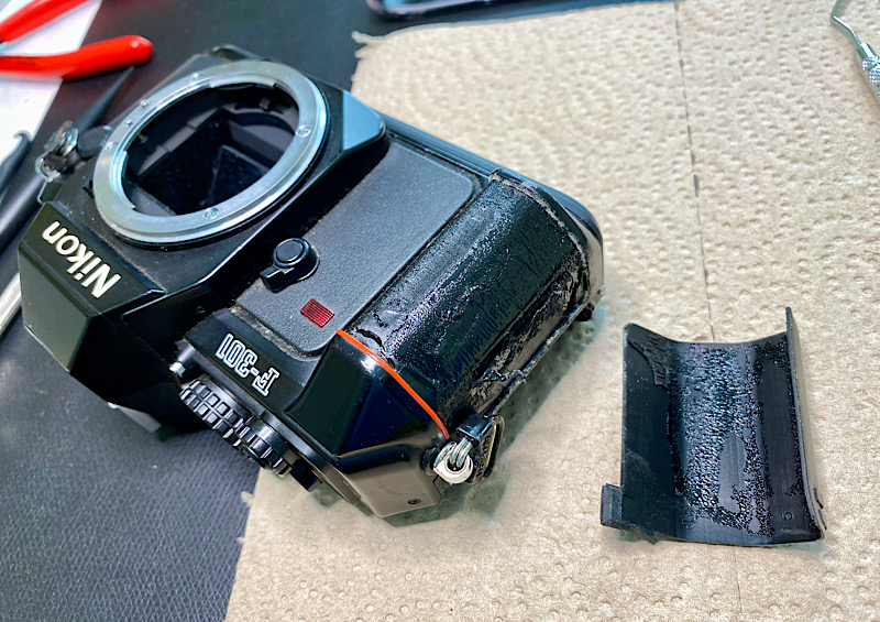

Since I want to get to the shutter, I first have to remove the top cover. Then I move on to the bottom plate and front panel.
Removing the plastic cover on the handle.
Jimmy from iFixit is perfect for removing glued leatherettes. Today it is being premiered.
It separates without cutting and pries. The flexible blade adjusts itself.
This makes it quicker and safer than before with needle, probe or tweezers.

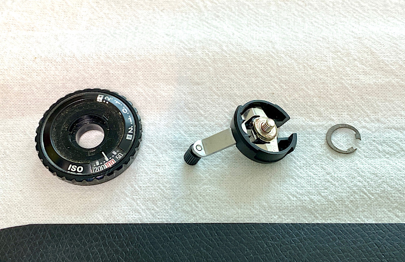

Rewind crank and ASA wheel are off.

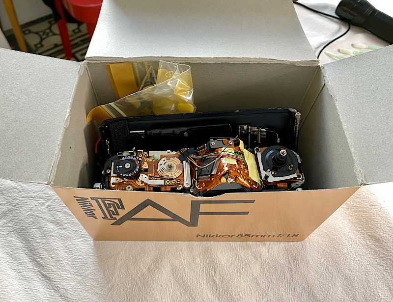

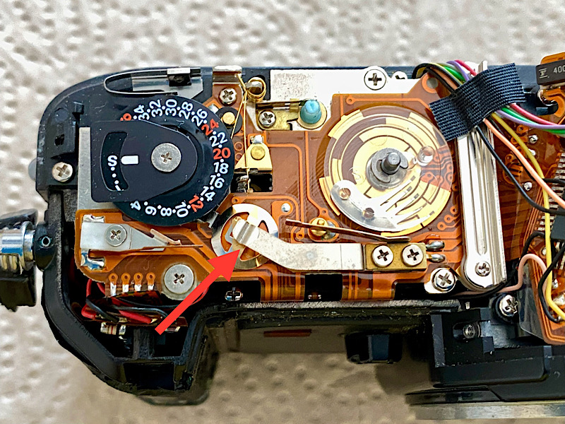

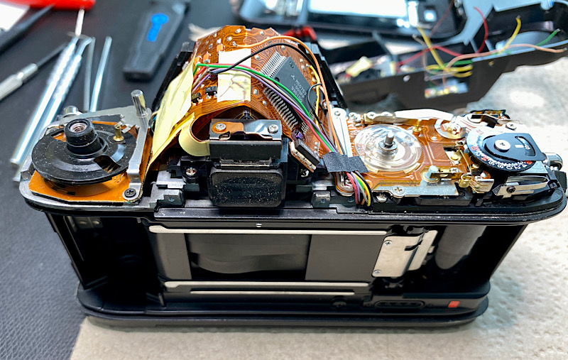

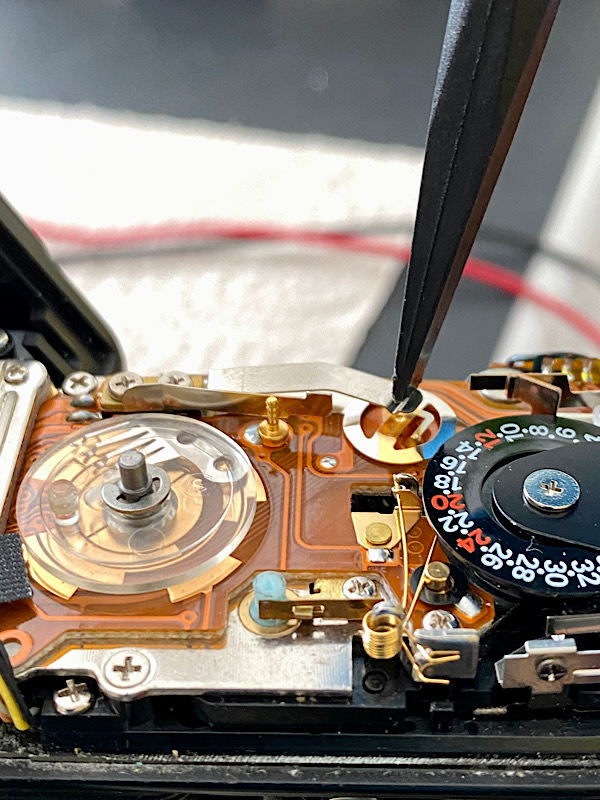

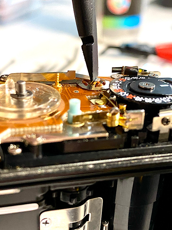

The top cover is fixed with seven screws.
Six of them are visible from the outside, I found the seventh after looking in the repair manual. It is hidden under the adhesive residue on the handle.
On the upper flexible circuit board of the F-301

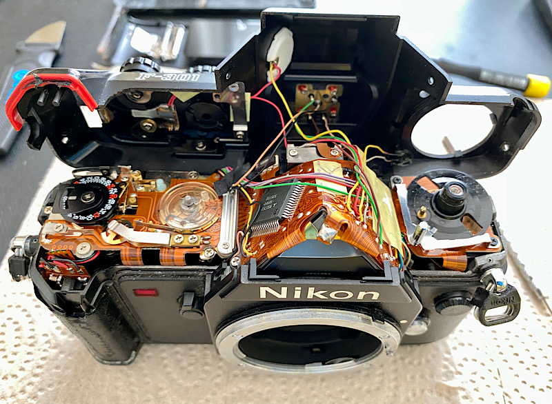

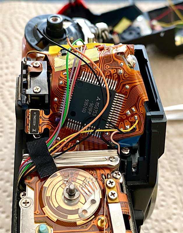

A look under the hood.

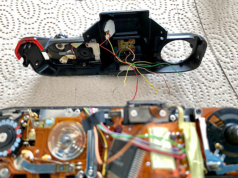

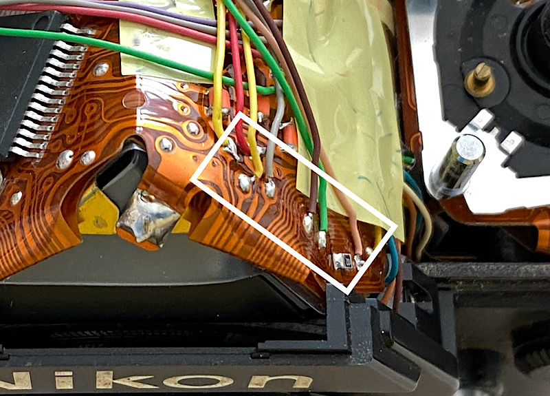

The top cover is connected to the housing via nine cables.
These two are desoldered from the cover ...
… and the remaining from the circuit board.
Completed

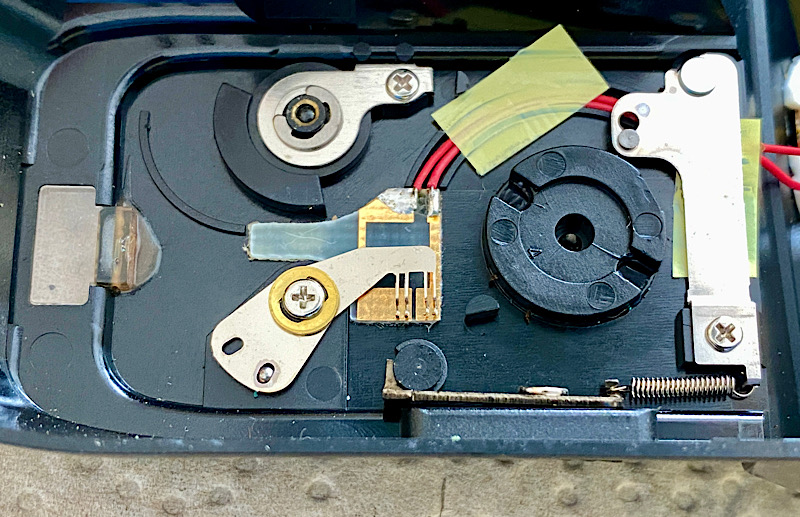

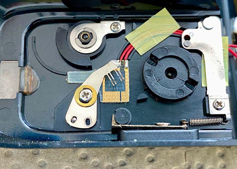

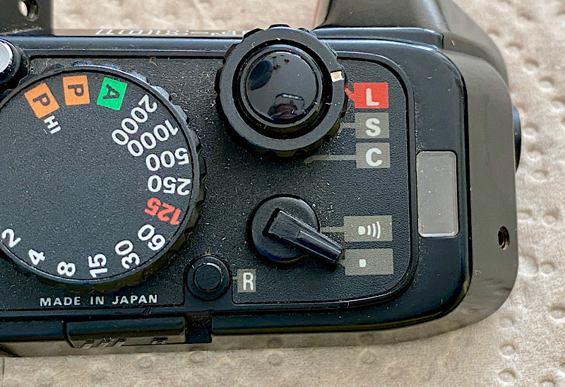

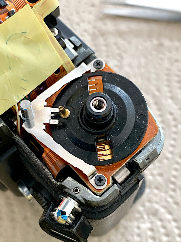

The rotary switch at the bottom right turns the signal tone on and off.
On the underside of the top cover you can see its coupled switch with wipers.
  • First position: switch off, no contact
  • Second position: switch on, contact

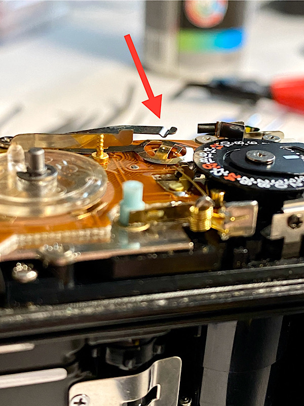

This is the shutter release contact.

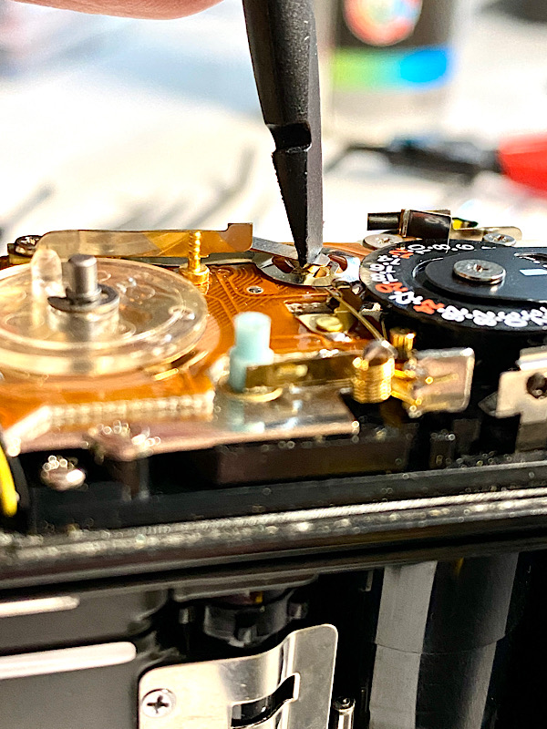

To the right above are contact tracks and wipers on a rotating disc that is coupled to the shutter speed button on the top cover.

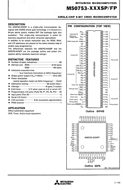

An IC from Mitsubishi with a designation whose data sheet I hope to find on the web.
The rotatable ASA/exposure correction unit.
Settings are transferred to contact tracks via sliders.
Rear view

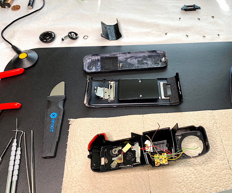

The parts removed so far.

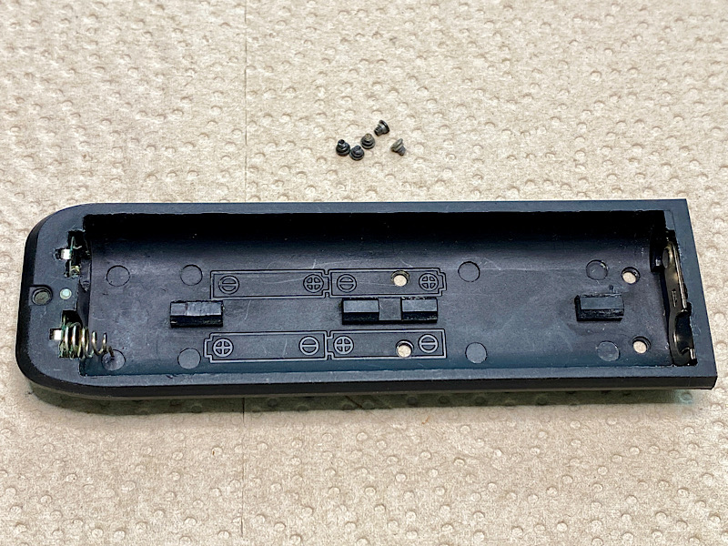

Removing the battery compartment
The battery compartment is removed after loosening five screws.
Andreas Thaler
Andreas Thaler
Nov 19, 2017
4,210
Vienna/Austria

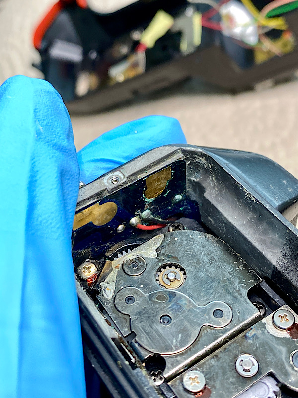

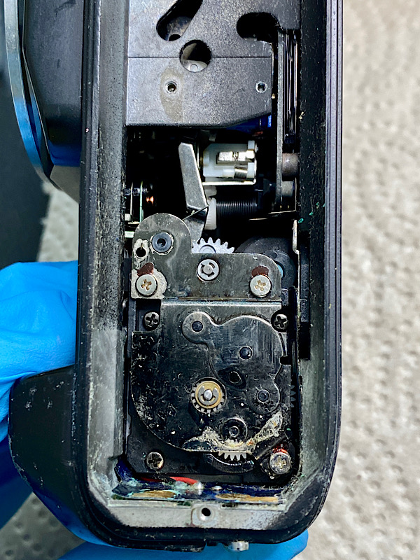

View of part of the motor gearbox.

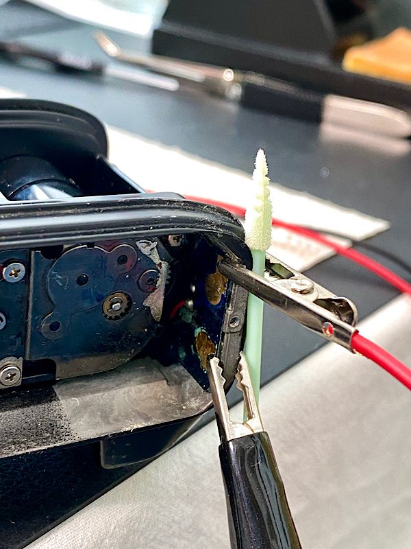

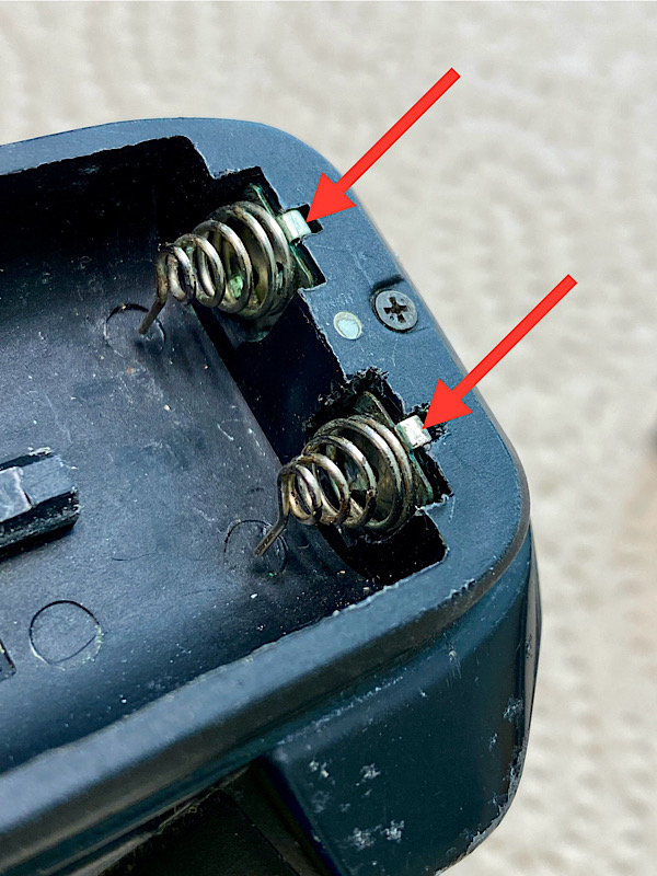

The battery compartment is connected to the housing via two contacts.
As is often the case, it is not enough to just clean the battery compartment. The battery acid also creeps into the area behind it and destroys contacts.

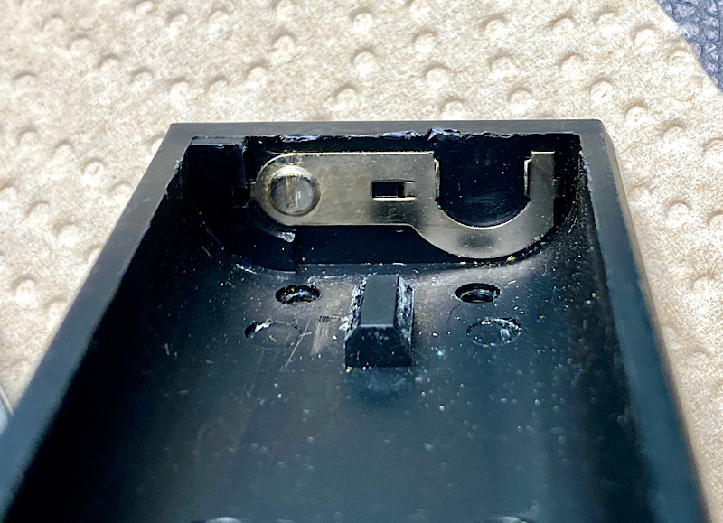

Problem with the power supply found
And now it becomes clear why the camera's circuit cannot receive operating voltage:
The left contact spring on the battery compartment is missing. So there is no connection to the contact in the camera housing.
An attempt has obviously already been made to repair it using glue.
I'll deal with that later.

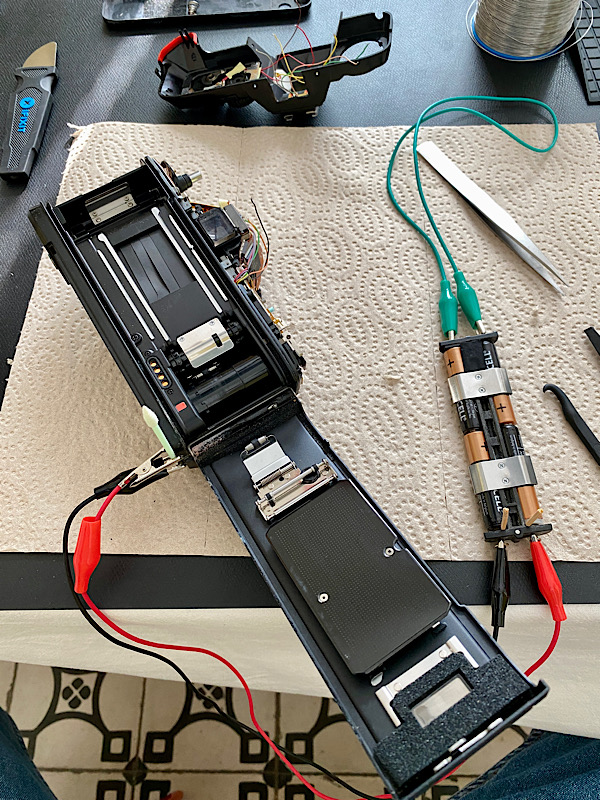

Improvised external power supply

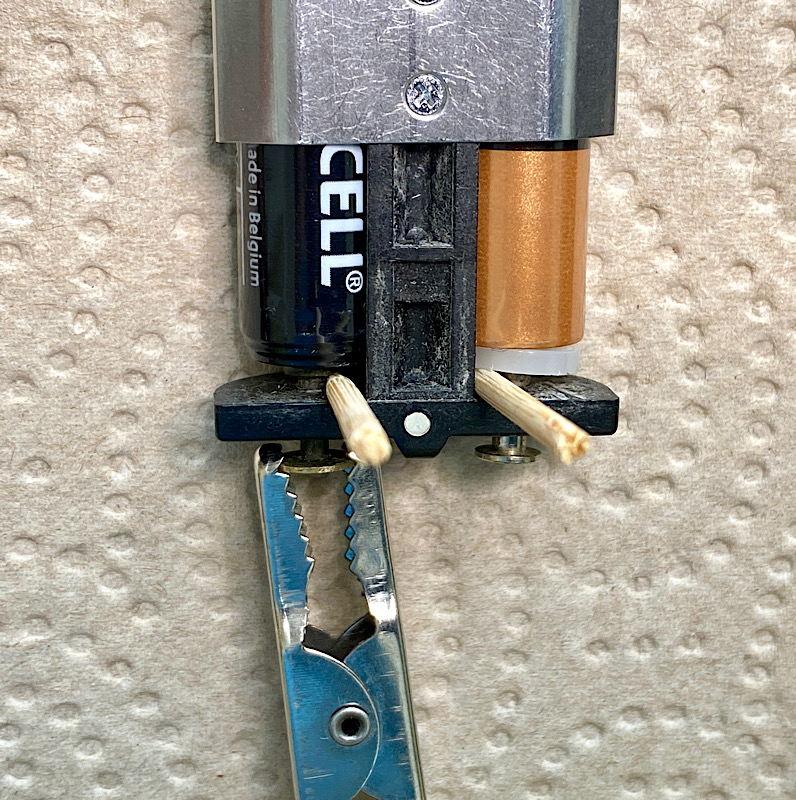

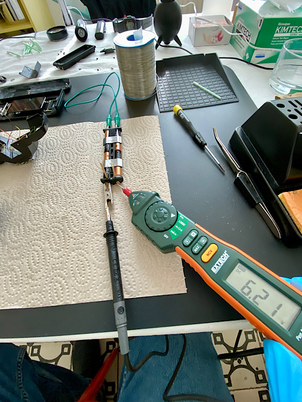

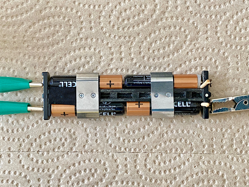

To determine whether the circuit works, I build an improvised external power supply from the battery holder.
It would have been easier to use my laboratory power supply, which outputs the desired voltage at the push of a button.
But I also wanted to use it to test the battery holder, which will then be reinstalled.
I connect the two pairs of batteries with a cable with crocodile clips (on the left in the picture). This replaces the contact bridge in the battery compartment. All batteries are now connected in series.
On the right you can see the crocodile clip of the negative connection of my multimeter, which I will then use to measure the open circuit voltage on the battery holder.
Since the contact springs for the pressure are missing, I insert the halves of a toothpick as wedges. Now the two contacts are connected to the batteries.
It works, 6.21 volts are now present at the battery holder.

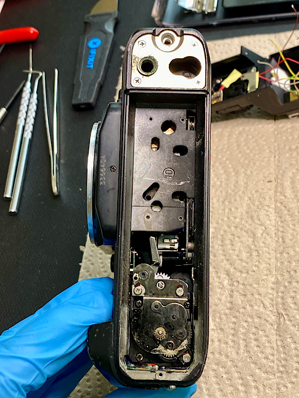

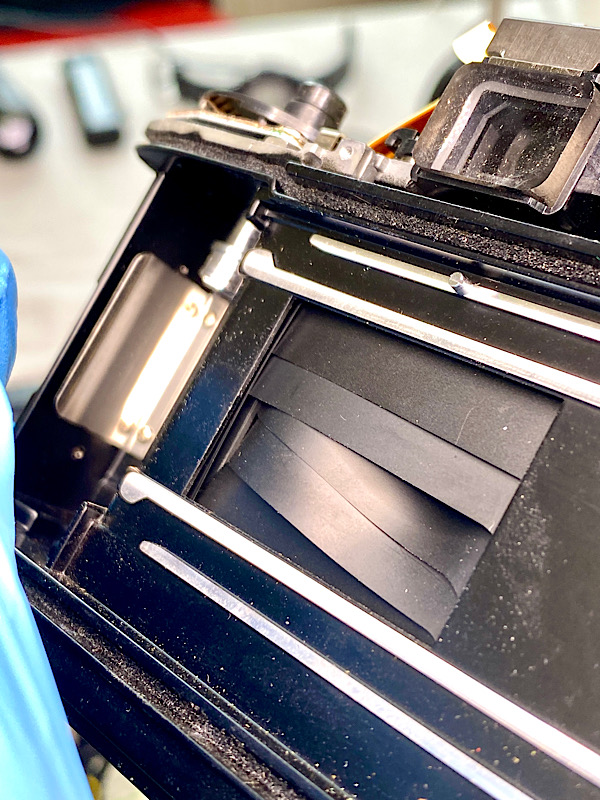

Mounting the shutter blades
I can put the shutter blades back into their guide.
But they remain deformed.
There is nothing that can be corrected here.
I think the blades are made of aluminum. They are flexible and can be bent, but they retain their shape. Once they are compressed or bent, it's over.
Connecting the camera to the external power supply

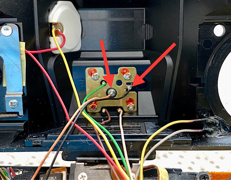

I connect the battery holder to the two contacts in the camera housing using two crocodile clip cables.
The black cable (negative connection of the power supply) is connected to the contact in the camera housing. At the same time, the crocodile clip also contacts the metal chassis. Since all those involved are at the same potential, the camera ground, that's fine.
The red cable is the positive connection. The crocodile clip may only be connected to the contact in the camera housing and must be electrically separated from the camera ground, otherwise the batteries will short-circuit. The plastic handle of a cleaning swab helps as insulation.
The external power supply is connected.

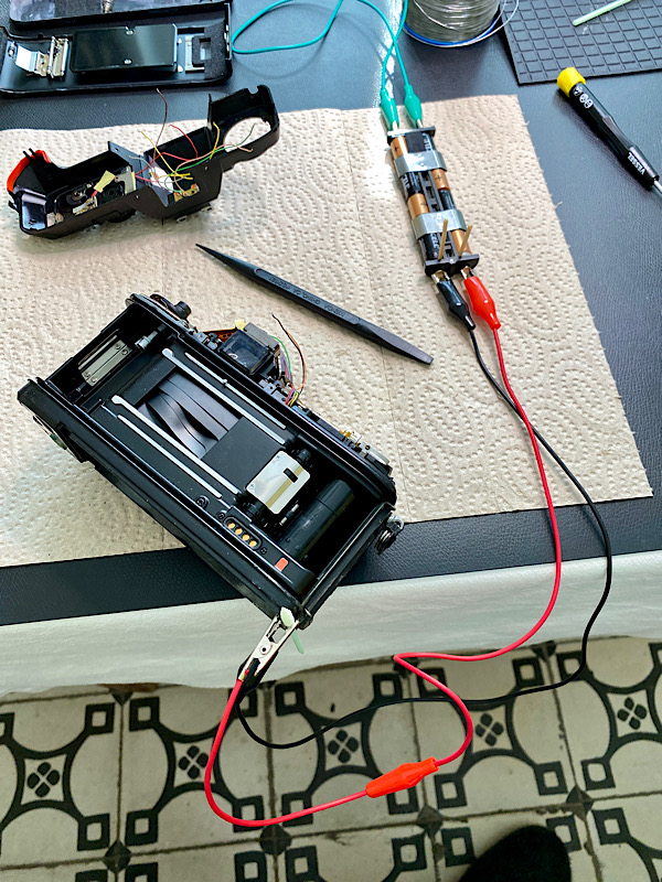

Test exposure metering system, automatic film feed and shutter release
An exciting moment:

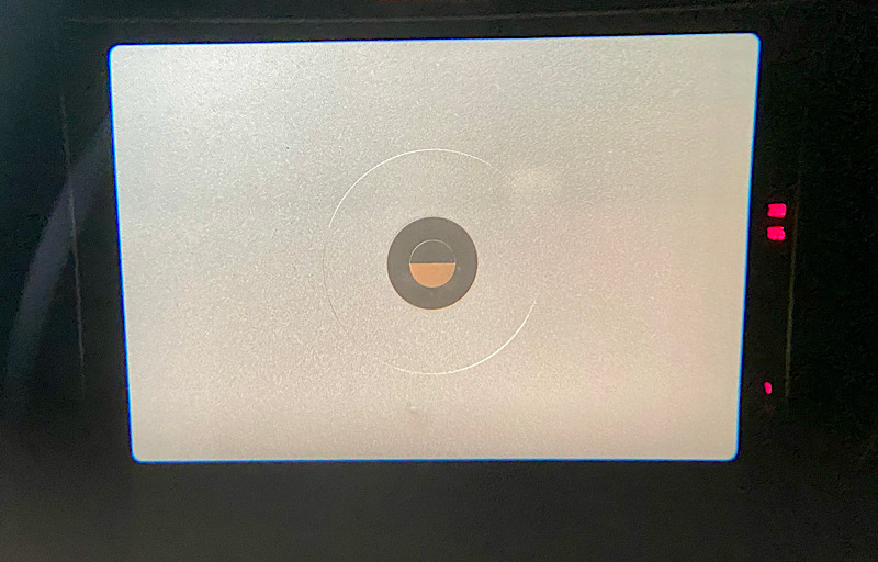

I activate the light meter by closing the first of two switches on top of each other, which is equivalent to tapping the shutter button.
Wonderful, the LEDs in the viewfinder are lit!
The circuit is intact so far.
And not only that.
When the second switch is activated, the motor is running and the automatic film feed with three forward switches starts.
The shutter blades remain closed.
Andreas Thaler
Andreas Thaler
Nov 19, 2017
4,210
Vienna/Austria
It took me a while to figure out how to release the shutter even when the backdoor is open.
The small switch in the camera body, which is pressed when the back is closed, must be held during the automatic film feed.
Then the shutter can be operated.
And it works.
The blades do not jump out of their guide in the film window.

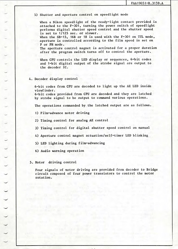

The repair manual for the Nikon F-501 comprises 295 pages and guides you very well through the disassembly process:
It is also interesting to read because it contains detailed descriptions of functions and circuits, which became less frequent in later models and were then almost completely omitted. Presumably because the steadily increasing range of functions and circuits of the cameras would have exceeded the format.
It also shows that Nikon was proud of its first SLR with a built-in motor drive, which came onto the market in 1985.
And rightly so 🙂

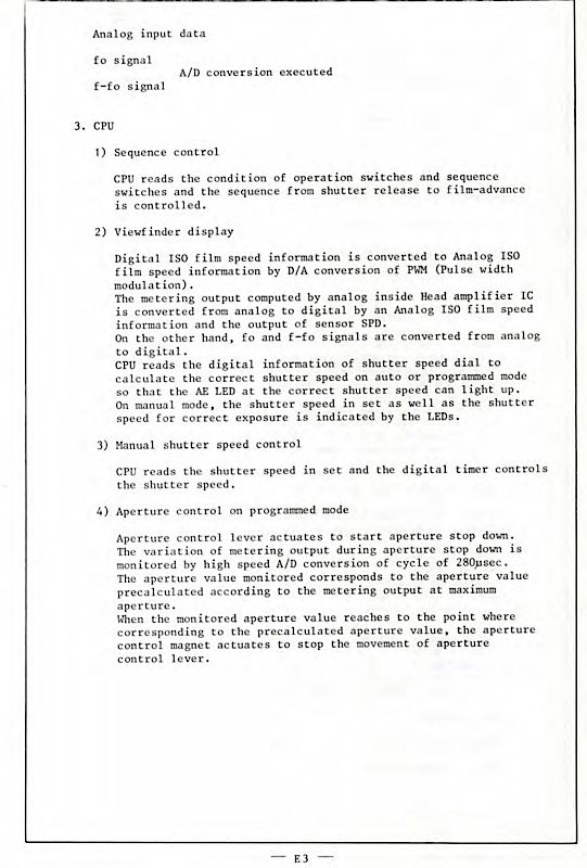

The F-301 is computer controlled
Data sheet for the IC - the chip family should be correct, but this is probably a different version:
(p. 242 PDF; 51,7 MB)
