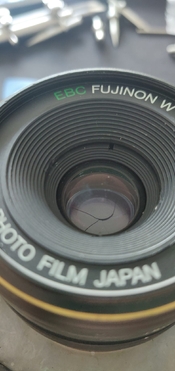

Dear all,
A year ago I got into the possession of a Fuji GS645S Wide60 from the flea market. Has its marks on the body but the glass is in pristine condition, which I had to get it for the price. The focus mechanism was sticky and with the help of the service manual I got it working again. Readjusting infinity and 2m focus and it was done!
However, a year later the shutter isn't working properly anymore. Actuating the winding lever and pressing the release button results in a click sound in the shutter and the shutter opening 25% and staying like this. This behaviour is independet of the exposure time I set as well as using it with the self-timer. Actuating the leaver again resets the shutter. But this way the camera became inoperable. I noticed that the lens itself and its different layers and rings is very loose. Therefore I assume that some screws got loose and need to be properly tightend and secured with loctite or similar. I completly opend the camera from behind the lens when repairing my first problem. But I never opened it from the front in order to reach the shutter. From the looks I don't quite get how to do that and the service manual is also not telling you how (most likely because the service manual only covers the body, not the lens/shutter). I'm pretty sure you have to unscrew the name ring where "EBC FUJINON W 60mm 1:4" is written on (I attatched a front view of the same camera from Google Pictures for reference). However, because there are no holes or notches in the ring, I cannot use a "lens wrench". Unscrewing by hand is impossible and I don't want to apply to much pressure (obviously).
What am I missing. How can I open the lens in order to reach the shutter mechanism? Do I need a special tool for this?

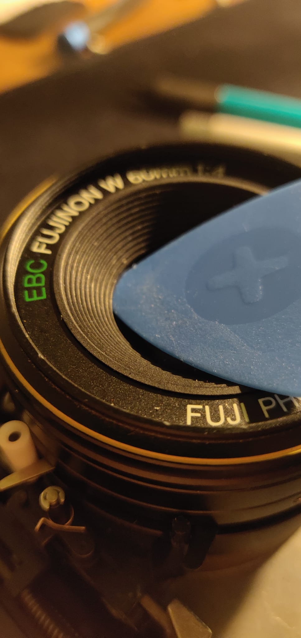

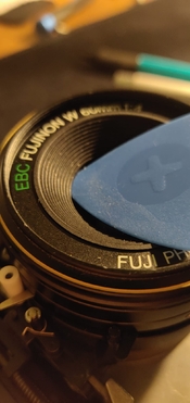

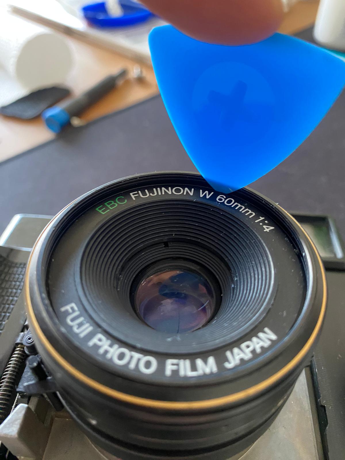

@OAPOli Ohhh, I see! So I try to pry it off gently from the name ring and then unscrew the name ring in order to reach the three screws beneath it?
Edit: Attatched is a close up picture of the front of the lens. I do not seem to see where I have any starting point to pry the cone of. From my point of view, the name ring and the cone are one part. The is a small gap between the front element and the cone and between the edge of the name ring and the barrel of the whole lens. But I cannot enter it at all with a slim plastic edge. Am I missing something?

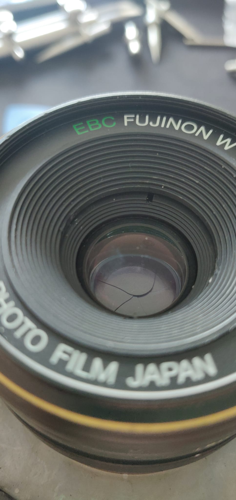

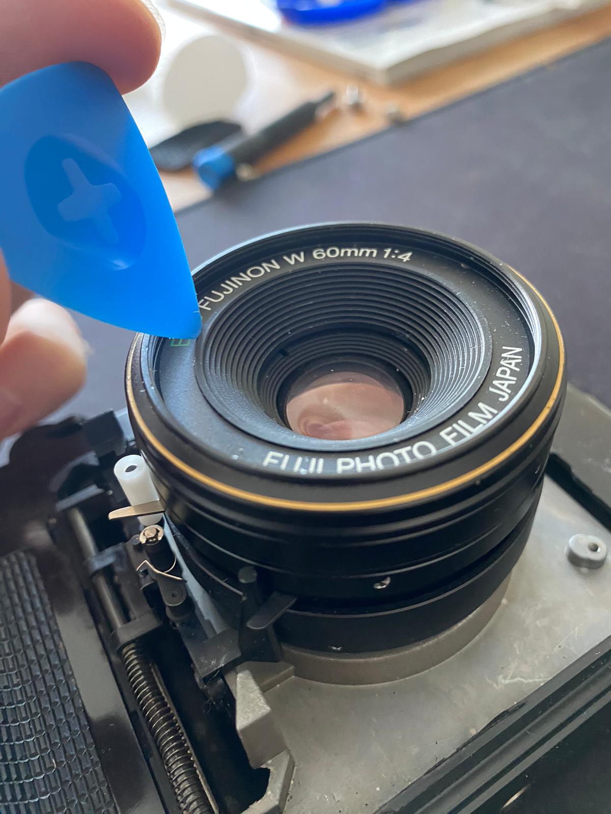

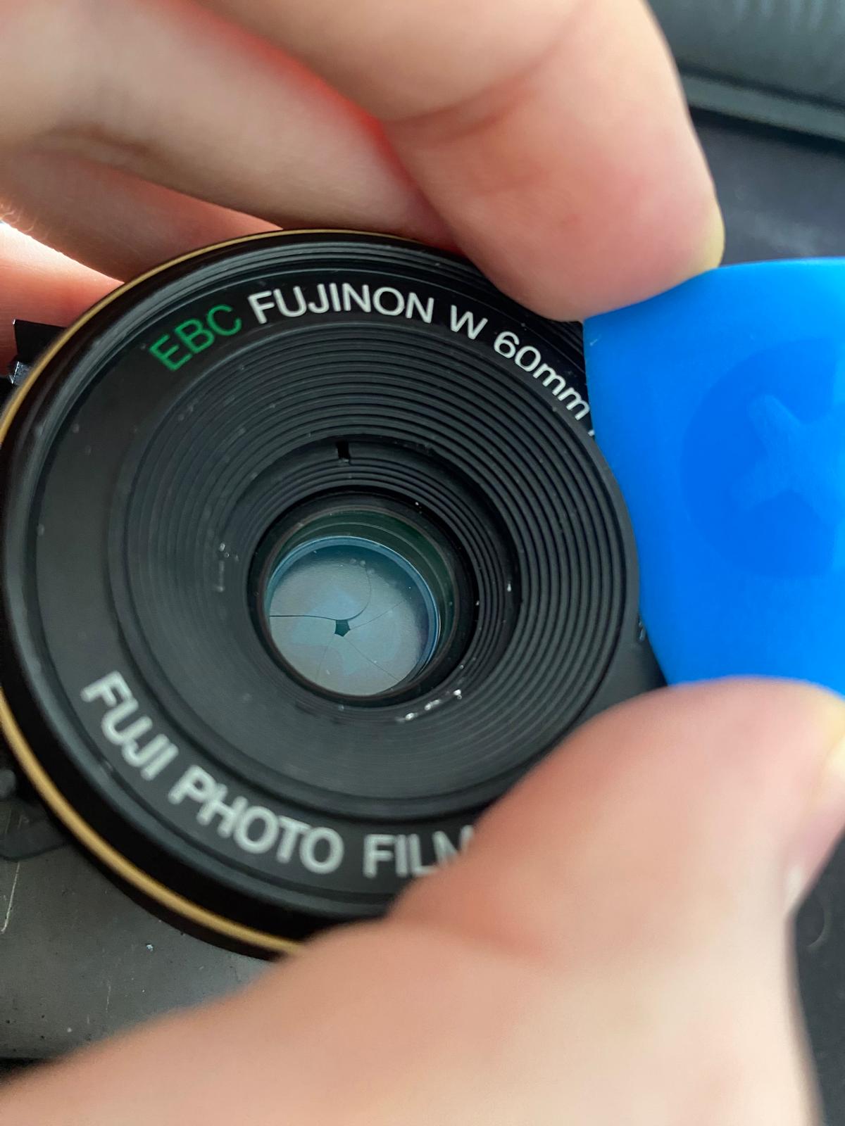

@OAPOli Thank you for your engagement in my issue! I'm not a a native english speaker so I fear that I misunderstand something or express myself lousy. I attached four pictures where I think a spatula can go at least. I assume now you mean the point shown in the first picture? (I ordered them in likeliness)

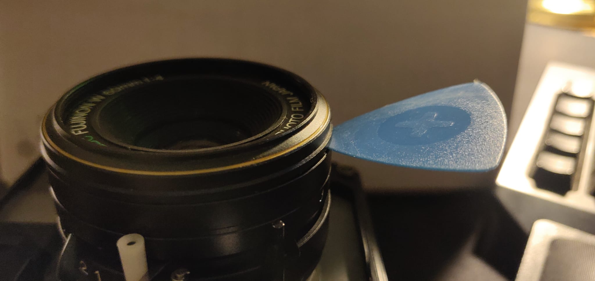

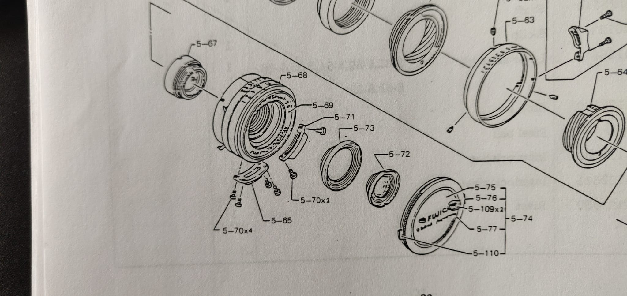

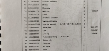

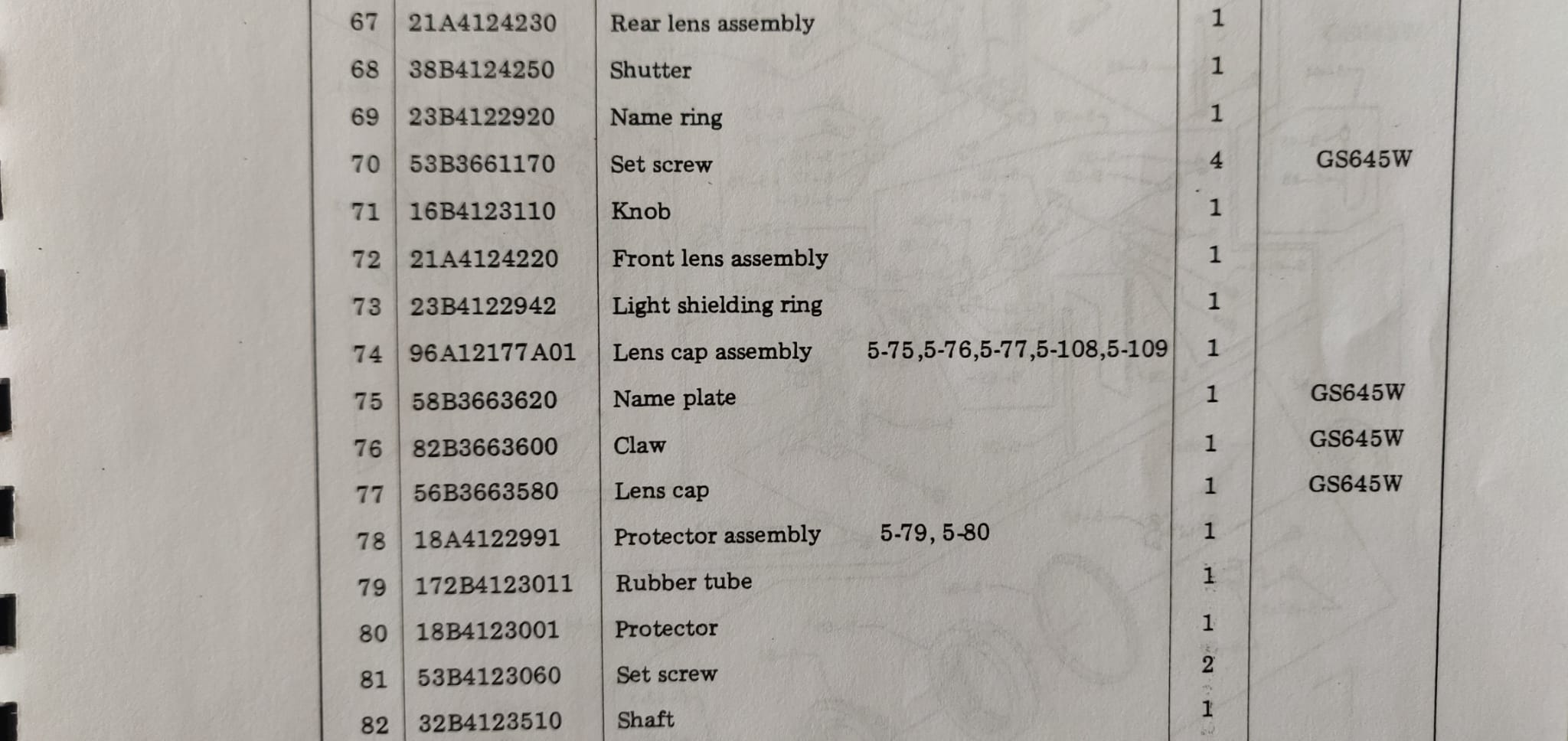

Thank you for encouraging me! I accomplished the removal with the plastic clip and removing it as shown in photo 4. I emphasize using something like this plastic clip instead of any metal tool in order to remove it as gently as possible. Beneath it are the three screws, which also are very loose. From here I can work further. Thank you again!
I attached some photos for the purpose of documentation.

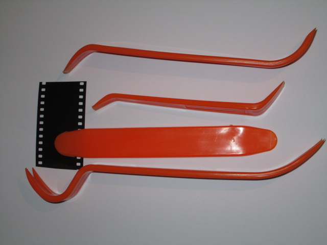

I removed the front cone exactly as you said.
I have a set of plastic car trim tools. Only used them once before. The set includes a load of metal hooks and prodders, not shown.
They only cost me about £6 for the set. They might look big compared to the piece of 35mm film added for sizing, but they worked fine.
Many Thanks.
p.s. if you click on the thumbnail you can see the ends of the tools. For some reason the thumbnail picture cuts down the size of the image.

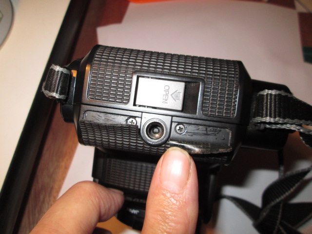

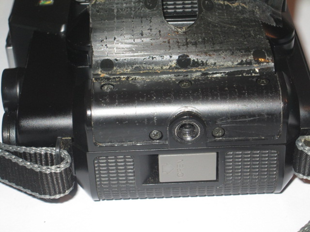

z0r I see from the first of your four pictures that you have removed the cover from around the base of the lens, where the lens
cover joins the camera body.
I have unscrewed the two screws on the right of the lens, and removed the buttons screwed to the focus, aperture and speed rings.
How did you remove the lens guard from the left of the lens ?
It looks like part of the textured hand grip needs to be removed to get at screws, but I cannot see the method of removing it to free the lens protection.

Underneath the textured handgrip are two screws which have to be unscrewed in order to remove the handgrip. After that, you can remove the front cover.

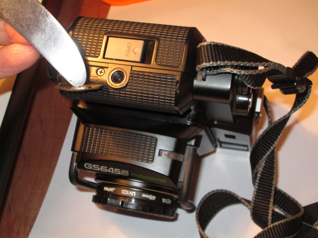

Do I peel off the textured rubber to see the screws ?
Thanks.

Yes, but gently. You may need to reglue this afterwards. I did that with Pliobond.

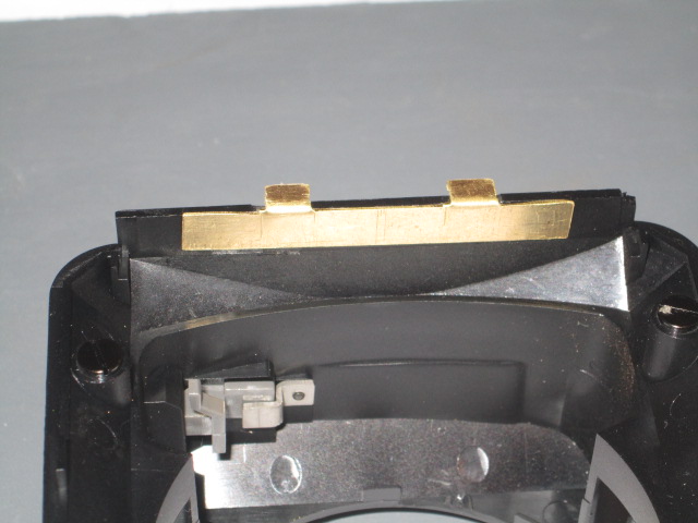

Plucked up the courage and peeled the rubber grip off. I used a blunt butter knife.
Three pictures showing the five screws that have to be unscrewed to get the rubber skin, and the grip off.
The wobbly body part around the base of the lens is due to the two lugs on the left having snapped off, and the two plastic screw tubes on the back of the facing had snapped off.
Humbrol Polystyrene Cement, sold for gluing scale model aircraft etc. , was used on the lugs but the two screw post will nee a lot more attention.
That's a job for this weekend.
I put the pictures up as it is easier for anyone at a later date to understand what is going on.

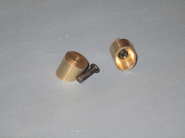

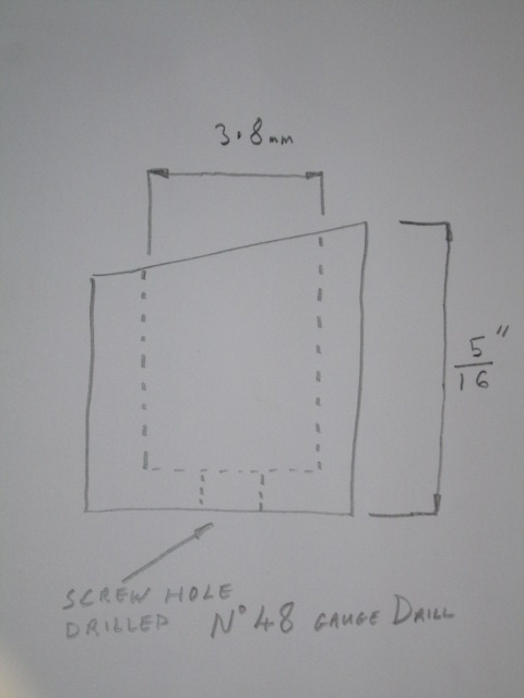

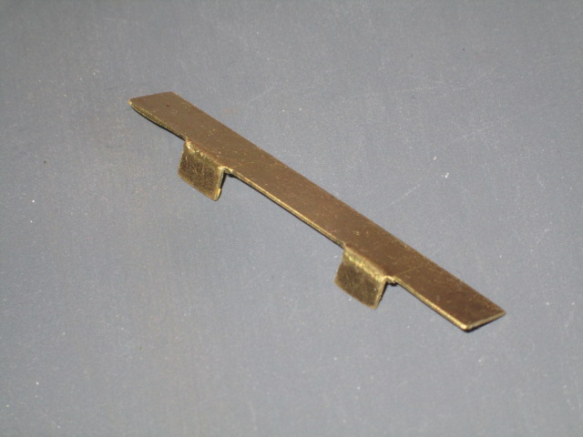

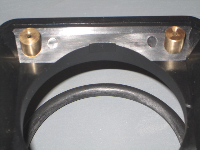

I made a couple of extensions for the broken stumps behind the cover to the right of the lens as viewed from the front.
The plastic was slowly crumbling away. While I was at it I removed the flimsily glued lugs on the left, then replaced them with a bit of filed and folded brass.
I used a lathe for the tubular fittings, but they could be made with care using a hand drill.
Please excuse the mix of dimensions on the diagram. Being of a certain age my head works in Imperial and Metric plus the unusual gauges used in engineering over the years. I just used whatever drill I had that fitted the bill.
The angle of the tubular extensions were eyeballed to shape when filing the slope.
I hope this helps others when trying to sort out the broken plastic fittings behind the nose cover.

Do not use too much glue on the tubes. You do not want it running down the post and gluing everything permanently.
The glue free brass tube face should be in contact with the chassis when gluing up. Lightly tighten the screw to do this.
You do not want an air gap between the chassis and brass tube face when the glue has set. As when the screw is tightened later it will pull the original post too hard and break it again.

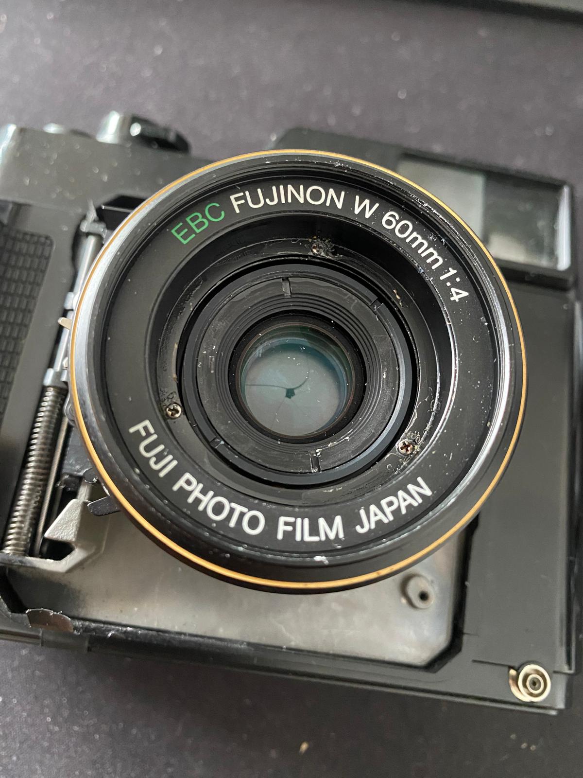

Hey, sorry for my lousy reply. I'm a bit busy at the moment. Repair Manual scan and viewfinder "service" instruction will follow in mid-end december. Sorry for that, but that takes some time. Wanna do it thoroughly. But it will come in a separate post. I'll inform you here.

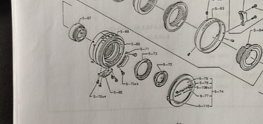

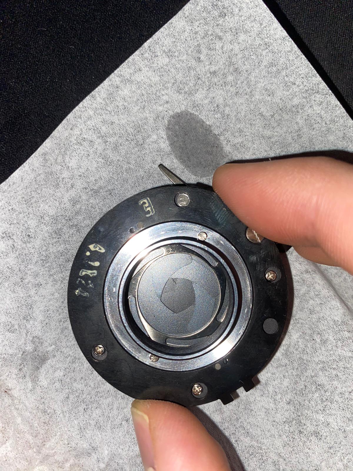

I nevertheless have a question to my problem: I did disassemble the whole shutter in order to get to my problem (I consider writing an instruction with pictures here as well because I did not find anything on the internet, so someone will most likely find that useful). It sees that a screw on the back is the problem (see attached picture, 12 o'clock on the ring, its the slotted screw). When I press the release everything runs very slow, mostly halts completly. I assumed oily blades etc., which is why I disassembled it completly and cleaned every blade with isopropyl alcohol. I even removed the guide ring and cleaned that. Reassembled everything: same behaviour. I noticed that when I release the aforementioned screw that suddenly I runs as intended. The screw, however, is now not really tighented, rather loose. This is most likely not intended. A friend of mine suggested that a washer is missing. However, when disassembling I did not find a washer at all. Also, the problem was already before disassembling the shutter at all. Does someone have an idea what I am missing? Just leaving out a screw feels very very wrong.
Looking forward to your answers.

Was the camera dropped at some point? A heavy shock can distort the shutter plate, so that when the rear assembly is attached, there is too much friction. I know this from dropping a camera on a cement floor 👏, although in my case I needed to loosen all four screws for the shutter to run (i.e. it's dead). That's my only idea.
There usually aren't washers behind those screws.
z0r
Oct 26, 2023
17
Germany
Yikes, cement floor sounds horrible! And four loose screws will always result in the blades getting funky. What a pitty.
But yes, judging by the view of the housing of my camera, there must have been a drop in the past. However, in my case I only have this one screw loose in order to get the shutter running. What would your judgement of the whole case be? Is it "reasonable" to leave that one screw out?
OAPOli
Sep 26, 2022
621
Toronto
A distorted shutter could imply a tilted optical axis.
I don't know what are the implications of using a shutter with a missing screw. Maybe it's fine.
