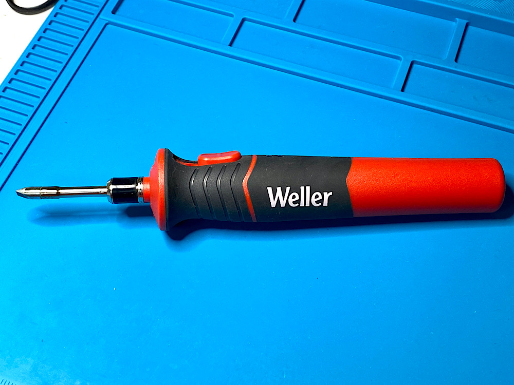

If you put some solder on the soldering tip, the heat transfer to the screw head is perfect. But then there may be solder left behind that you have to scrape off or remove with the desoldering braid so that the screwdriver can take hold.
Currently my cordless soldering iron with a wide soldering tip is my star for this purpose. It has too much power for soldering electronics, but it is suitable for screw heads 👍
