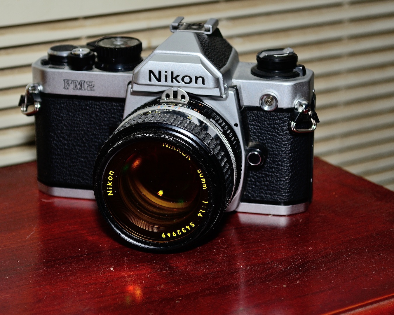

Don't have experience with many others but if I had to choose it would be between my F5 and Fm2n. The FM2n would win 'cause of the mechanical nature.
