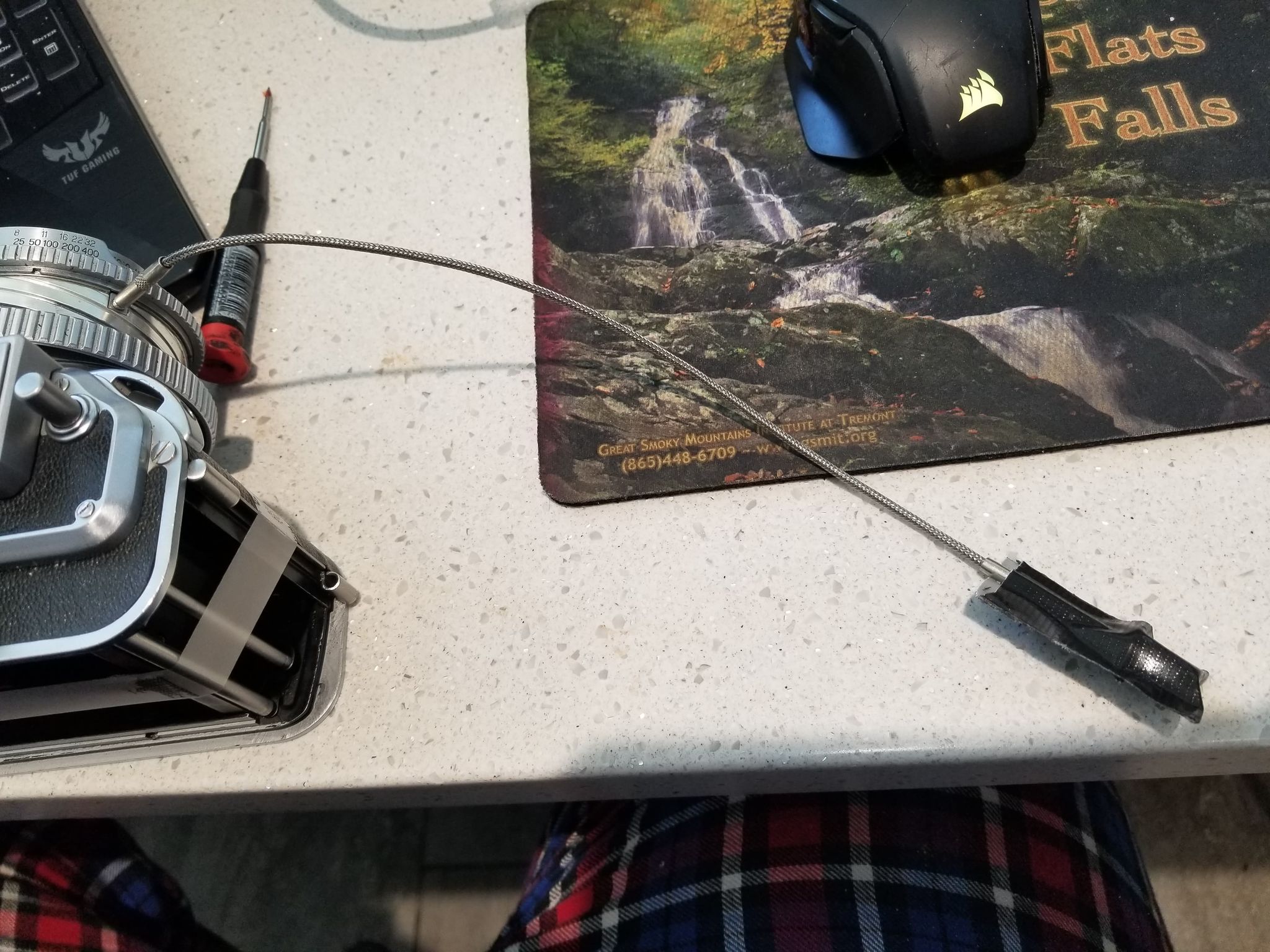

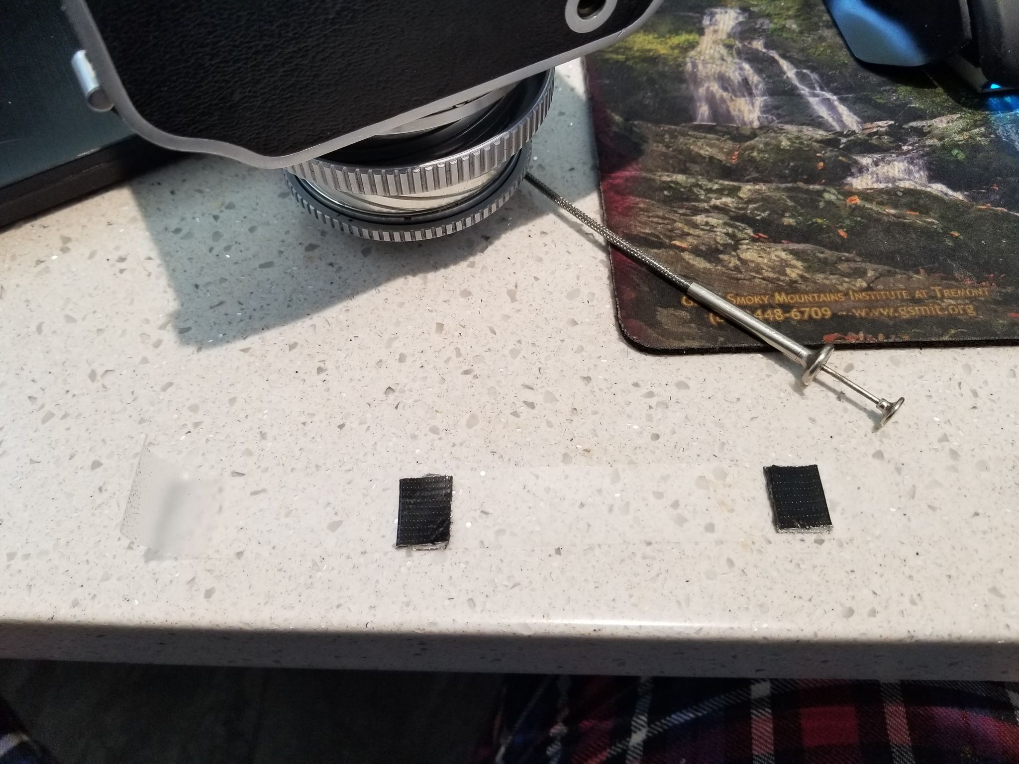

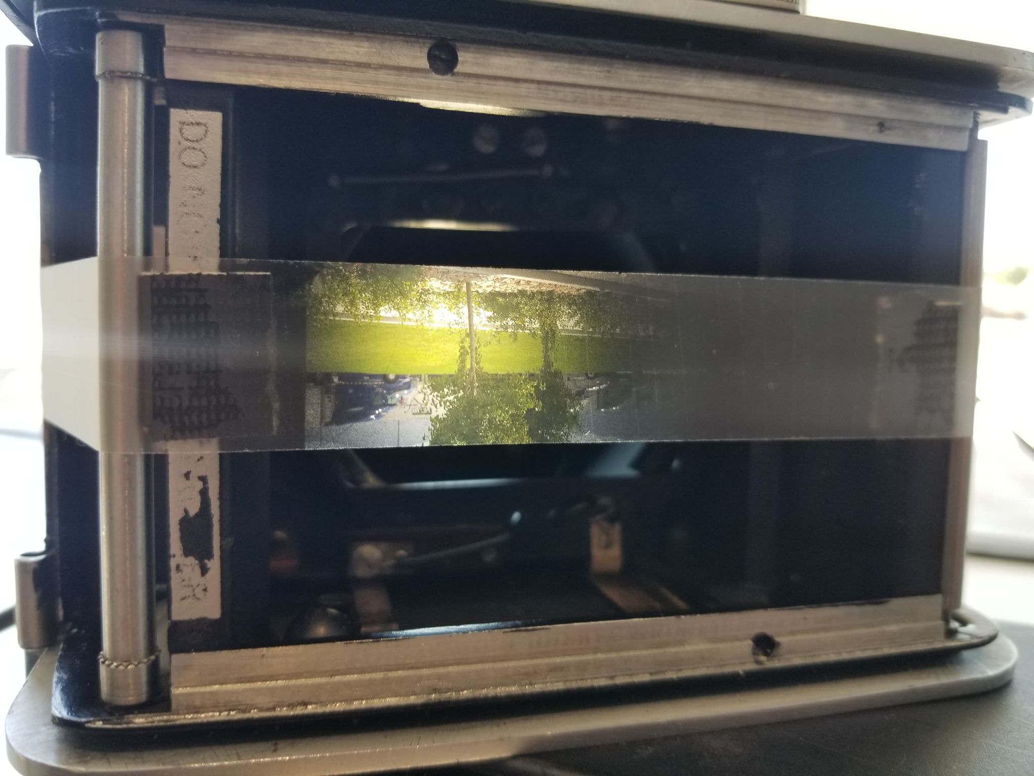

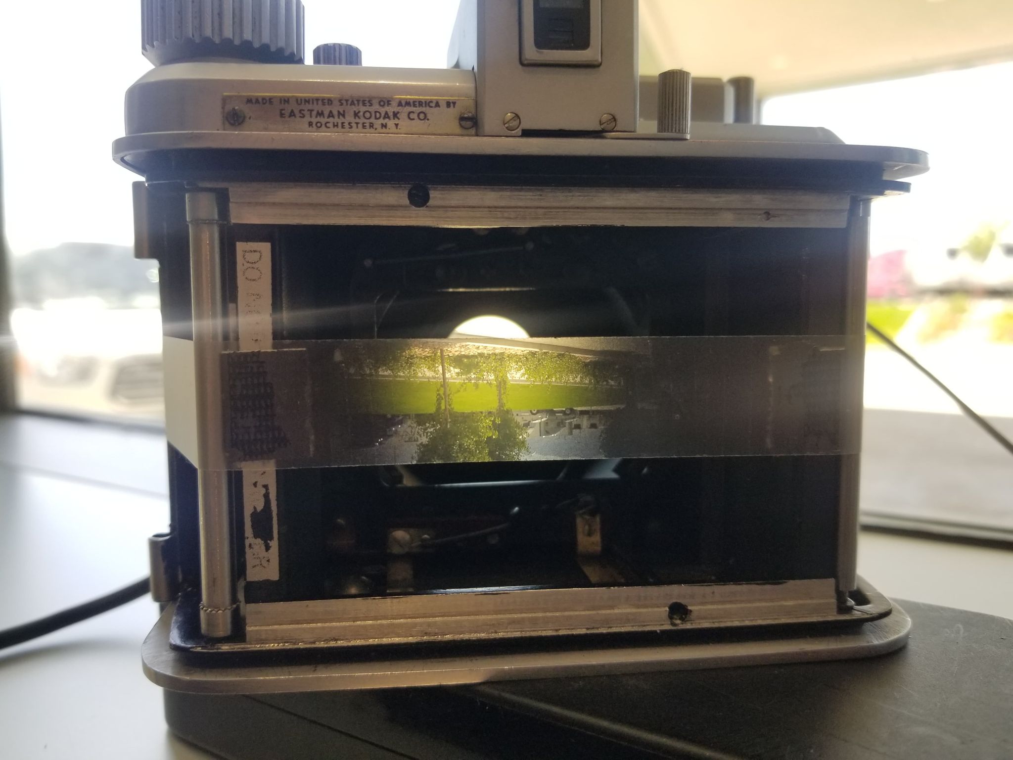

here is my RF calibration rigged setup, it's only stupid if it works. I folded a piece of Gorilla Tape on both sides to get the spacing for the film plane and it was dead nuts on the nose.
Hey, nice work! I use cd cases cut to size on a band saw and made matte on on side with steel wool and water. Mini ground glasses on the cheap.
