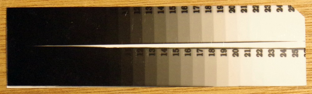

I'm not Matt, but your request made me realize that (1) I can do that, and (2) I can do that with a Stouffer strip. I exposed a Stouffer strip on to a piece of Ilford MGRC Deluxe (AKA "MGRC V") twice, one hour apart.
The upper half was exposed an hour before the lower half. I developed it immediately after making the 2nd exposure. Both exposures were grade 2, and I double-checked that both were identical.
They look the same in the digicam image above. But the densitometer tells me that the light tones are 0.03 to 0.04 stops lighter in the upper half, and the dark tones are 0.06 stops lighter.
Thus, there is a small amount of latent image loss. For critical work, you might notice the loss in the shadows if you spend a long time burning after making the base exposure.

Thanks for posting that shot albada. From that, I wouldn't worry about latent image stability unless the film or paper was was stored for an extended period before developing.
Film could maybe take more storage time than paper. It's made to be put in a camera and left in there for extended periods at mid roll. You could take a day or a month to shoot a roll w/o any changes in the images on it. I've never seen any problems on my films, and never heard of it being an issue.

The difference you see in your test strips is so small, it may be just as easily attributable to slight variances in exposure time or light intensity from your enlarger as it is to latent image degradation.
At any rate, it seems that for the paper you tested, latent image degradation can be safely ignored for all but the most exacting situations.

albada
Apr 10, 2008
2,175
Escondido, C
Mark,
I made the exposures using an electronic controller connected to a LED head, so exposure is accurate down to the microsecond. Also, I can visually see that the darker tones on the lower half are a bit darker than the upper half. So I think the differences are there. But I agree with your conclusion: For most people, latent image decay in prints is not a problem.
A couple of people asked about film. I suggest reading the posting by @Stephen Benskin at the beginning of this thread. It turns out that you can up-rate film some if you are able to develop it soon after exposure. But IMO there's a big difference between film and paper: With film, you can compensate for latent image loss during scanning or printing. With paper, there's nothing you can do (well, maybe you could over-develop it, but then you risk fog).

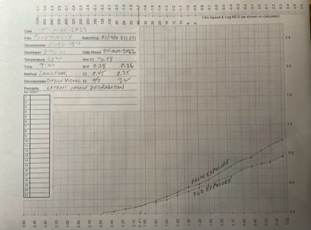

I created a separate thread for this but thought this fits in here.
I inadvertently did a “long keeping time” test with Panatomic-X because I put a sensitometry exposure on a roll before I shot it, then just before developing I exposed a separate piece of film.
I’ve always tested Panatomic-X to have higher than 32 speed, but always used it at 32 speed.
So what I think I see is you get 32 speed if you wait a long time between shooting and developing.
