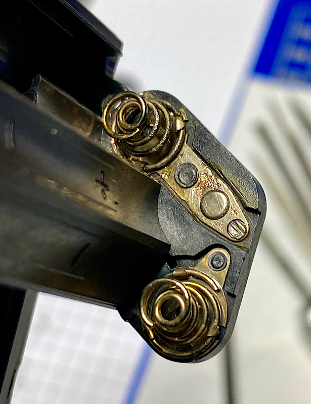

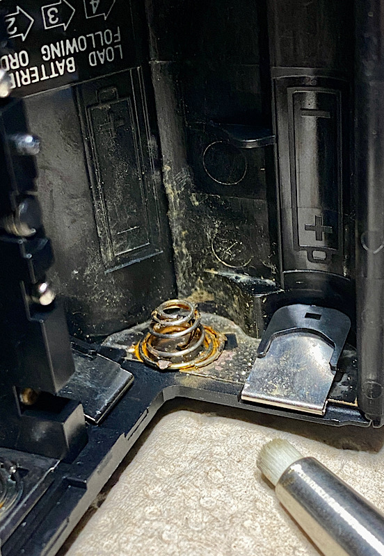

Battery holders: reworking the battery contacts
After bathing in Durgol descaling solution, rinsing with water and drying, there are deposits on the contacts damaged by the battery electrolyte.
It looks like light rust and can be removed with the fiberglass brush.
I will try to see if I can clean it with a plastic or brass wire brush on the Dremel Stylo.
If not, then I will try it with rust removal solution.
I see this for the first time when working with Durgol.

I'm making progress with the plastic brush, the brass brush will be even more effective, but I can't get to the gaps.
So now it's time for the rust remover.

Forgotten batteries in electrical devices can have terrible consequences: the battery electrolyte spreads through cables and circuit board conductors and attacks metals.
A process that progresses over years.

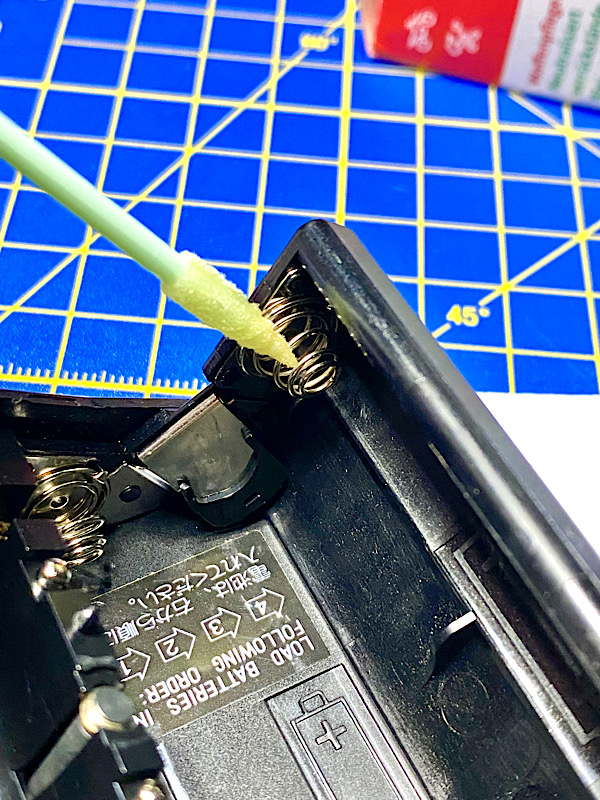

I was able to remove some more corrosion.
The finish is acceptable to me, what is important is that the corrosion has stopped and the battery holder conducts current reliably.

Finally, I sprayed all the contacts with electronic cleaner, which also forms a protective film.
The excess spray evaporates and does not attack plastic.
Ventilate well.
