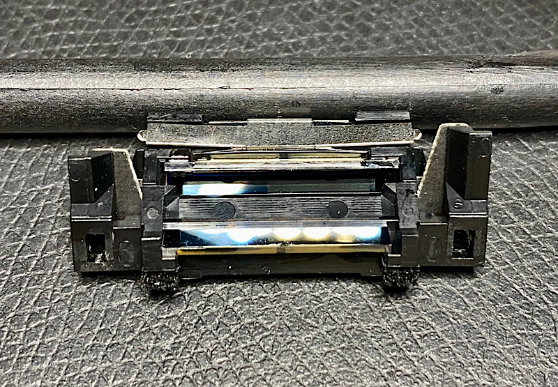

Here is the mirror box that I removed from my training 7000:
The magnet is closed (blue arrow) and the pawl on the encoder gear is released (white arrow). The aperture can close to the selected value.
The magnet is open and the pawl on the encoder gear is engaged. The aperture is closed to the selected value.
The position of the aperture is determined solely by this mechanism. The further the aperture ring with coupling rotates in the camera bayonet, the smaller the aperture created.
What I am observing now is similar to the Nikon F4, whose aperture is also formed by an encoder mechanism.
If I move the aperture ring quickly back and forth via the coupling, there is a screeching noise.
This is not the case with the training 7000.
That would be an indication that the encoder mechanism needs oil.
This corresponds to the third cause of error in the list above.

Here you can see the star-shaped encoder in close-up (blue arrow).
It is connected to the gear above and runs through the light barrier of an LED (white arrow). This generates an ON - OFF pulse that will be transmitted to the aperture control.
The encoder tells the aperture control which position the coupled aperture ring is in in the bayonet.
When the selected aperture is reached, the switching magnet opens and transfers the movement to the gear via the pawl, and the encoder with the coupled aperture ring is stopped.

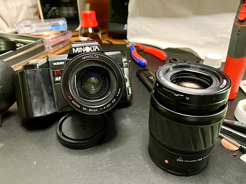

I got a working one of these attached to a mouldy lens. Playing around with bulb mode and detaching the lens after opening the shutter to try wiggle the aperture set ring, my guess is it doesn't bother releasing the electromagnet with no lens attached so the thing can freely rotate?

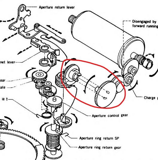

It's a confusing mechanism. I'm not sure what's decoupling the mechanism from the motor. There's also the chance mine isn't fully working though, I'm not feeling any backlash absorption springiness...
Like what's this part all about? What's "Disengaged by forward running" mean? I'd assume the motor can't operate in both directions since it's attached to the film... but then again that'll have a slip clutch built in, so maybe it does reverse?
Yes, I observed this with a functioning 7000.
When the shutter is released without the lens attached, the ring with the aperture coupling rotates.

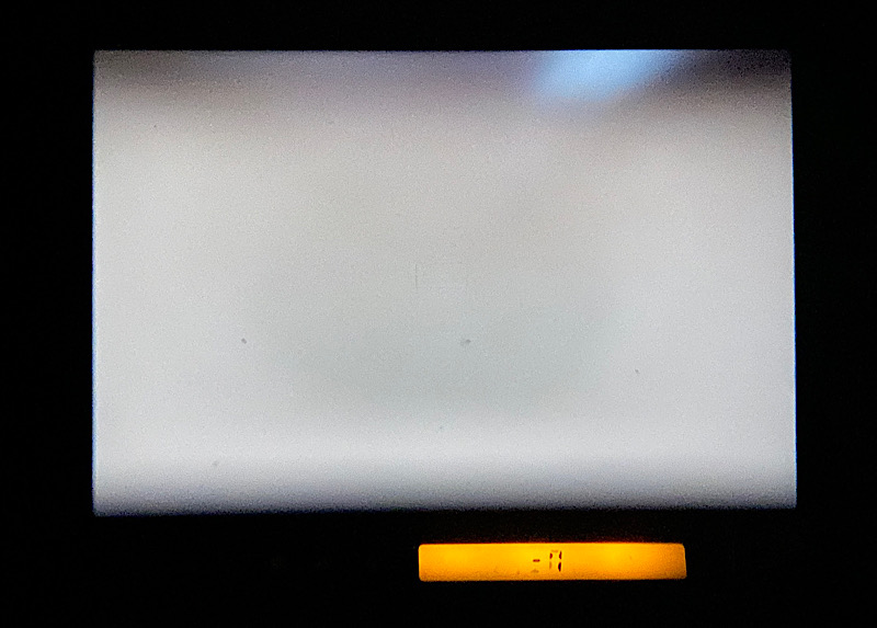

Here I have a 7000 that works but the viewfinder display shows almost nothing.
I will examine the display and see what I need to replace or clean, parts are available.
In the service manual, on page 243 (PDF) „Servicing measures against ‚in-finder segments OFF‘“, there is information on the structure of the display unit and instructions on cleaning the contacts.
I suspect that there are contact problems due to oxidation.
I'll take a look at it tomorrow.

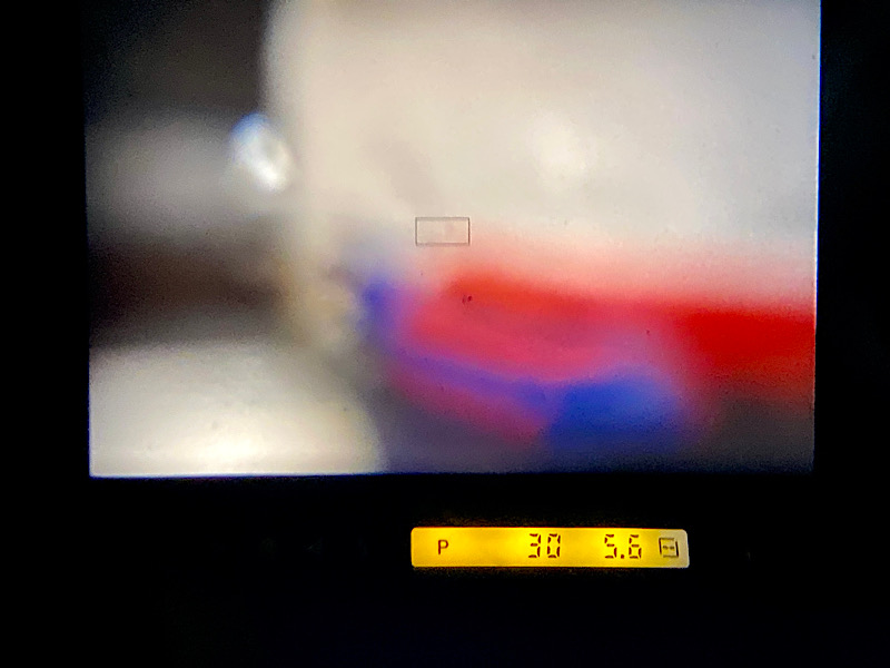

Display unit successfully replaced
Now it worked after all 🙃
I took the display unit from another spare 7000 and inserted it into my patient.
The process:
Cleaning the faulty display with acetone. I wasn't sure whether the glass should be free or whether the existing residue was necessary for the contact. So I only cleaned it superficially. That at least brought a few digits onto the LCD.
To make sure that the display unit was being controlled by the 7000, I used an oscilloscope to measure some contacts on the circuit board for the display unit. Regular square wave signals were visible, so I assumed that it was OK.
Then I installed a display unit from a spare 7000 into the patient. Again, only a few digits were displayed, even though the display unit on the spare 7000 was working perfectly.
I then cleaned the display glass thoroughly with acetone and isopropyl alcohol until it was shiny.
I also cleaned the contacts on the board with acetone and isopropyl alcohol.
Parts of the LCD display were now shown correctly.
By moving the contacts with the retaining clip inserted, I was able to completely restore the display.

Combined diffuser/magnification bar made of transparent plastic, removed.
On the left a diffuser for illuminating the display with daylight, below three amber-colored miniature LEDs for artificial lighting, which switches on automatically.
The mini magnifiers on the right are probably used to reflect the miniature LEDs for AF (3) and flash readiness (1). This increases the brightness of the display, which is guided into the viewfinder via two mirrors.
The socket for the LEDs has been removed. Above that is the LCD with a polarizing filter film.
The LCD removed.
Mirror one …
… and two.
An incredible construction.
