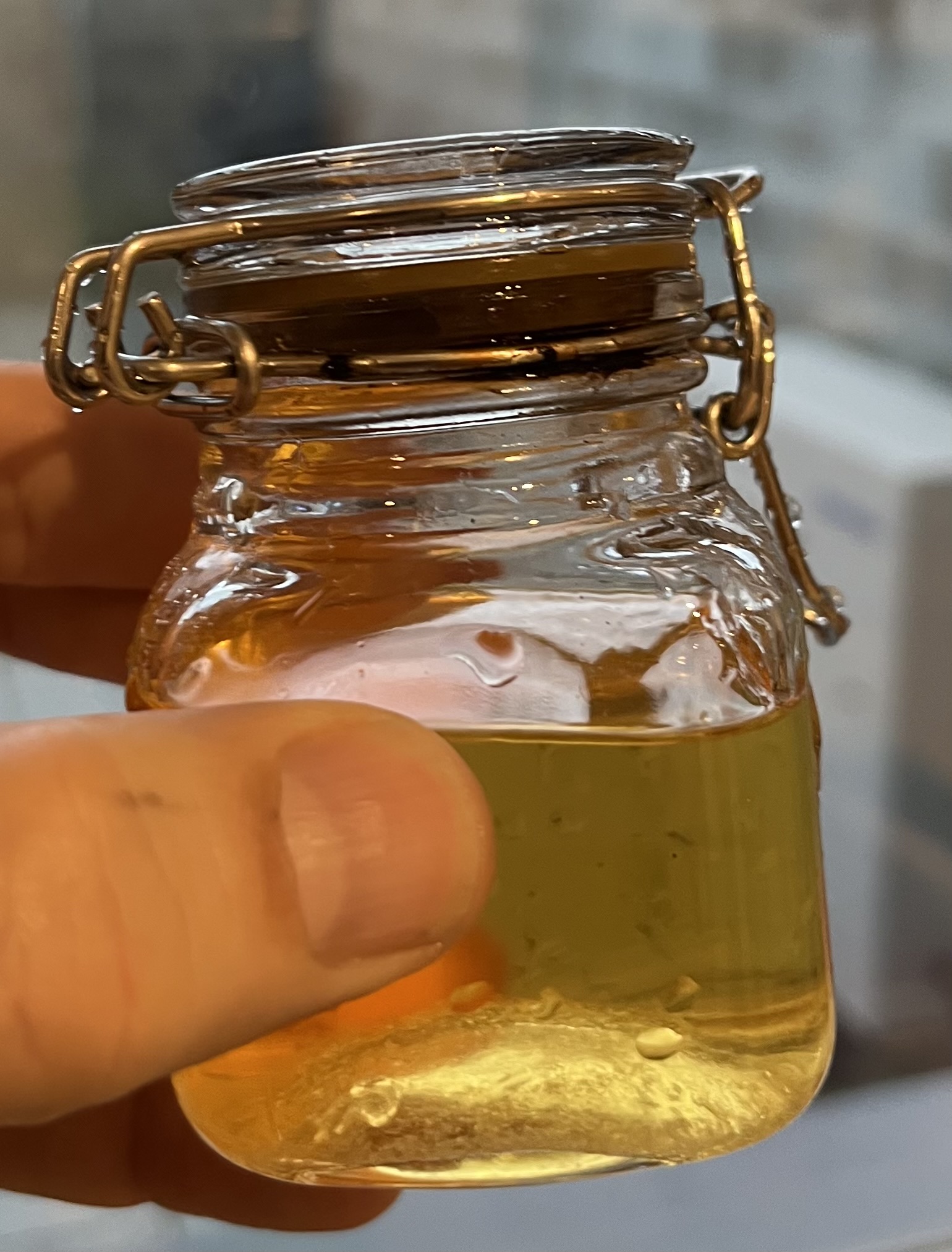

Developed a roll in this batch of PC-512 Borax that I’ve left sitting in its jar (in the dark) since February 2023. It’s a bit yellowed but dev time was exactly the same.
The fact that the Fenton reaction did not destroy the ascorbate over that 1.75 years of sitting indicates that both your water and chemicals contain little iron and copper impurities. The fact that PC-512 Borax contains no sodium sulfite helps reduce these impurities.
Mark
Yes, there’s no water other than whatever minute amount was dissolved in the (food grade) propylene glycol. The ascorbic acid powder and phenidone seem to be quite clean. The ascorbic acid is food grade stuff from German eBay that I bought in bulk about 13 years ago. I’m still using what’s left of 25g of phenidone I bought from Bostick and Sullivan in 2014 when I lived in Portland. The water and borax (20 Mule Team) only meet the developing agents at dev time and don’t have enough time to do much damage. That was part of the reasoning. It’s nice to see that it’s working out as expected.
I wrongly assumed that the solution was aqueous. Actually, you have AA and phenidone dissolved in PG. Now its long life is understandable.
An observation: in years past, folks have noticed that an alkaline developer dissolved in PG lasts about 6 months before getting rather yellow (oxidized). Your solution is acidic, and is still fine after nearly two years. Good to know...
