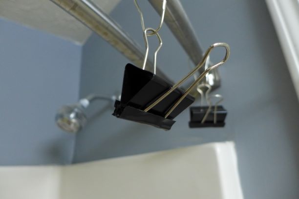

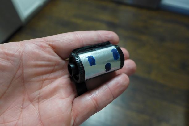

I have been wanting an Olympus XA so that I could have a point and shoot where I could use my bulk-loaded film. But I'm too poor to afford one. I once had a Stylus Epic, but sold it, even though I genuinely liked it, because someone was happy to pay too much for it. Then I came across the original Epic for $2.99.
I like it and want to keep it, so I decided to do homemade DX coding. Others have scratched off existing DX codes, and one guy posted a tutorial for printing out paper and creating your own DX code, but it was VERY complicated. I decided to simply use foil and paint in the boxes with craft paint instead, which was fast and easy:
I'm sure it's been done before. You can use Thom's guide here for the proper DX coding: http://www.filmbodies.com/articles/dx-coding-on-film-canisters.html
I also did not want to pay $15 for plastic clips to hold my drying film. So I made this, with office clips and electrical tape:
If you have some tips for your fellow poor man, please share!
