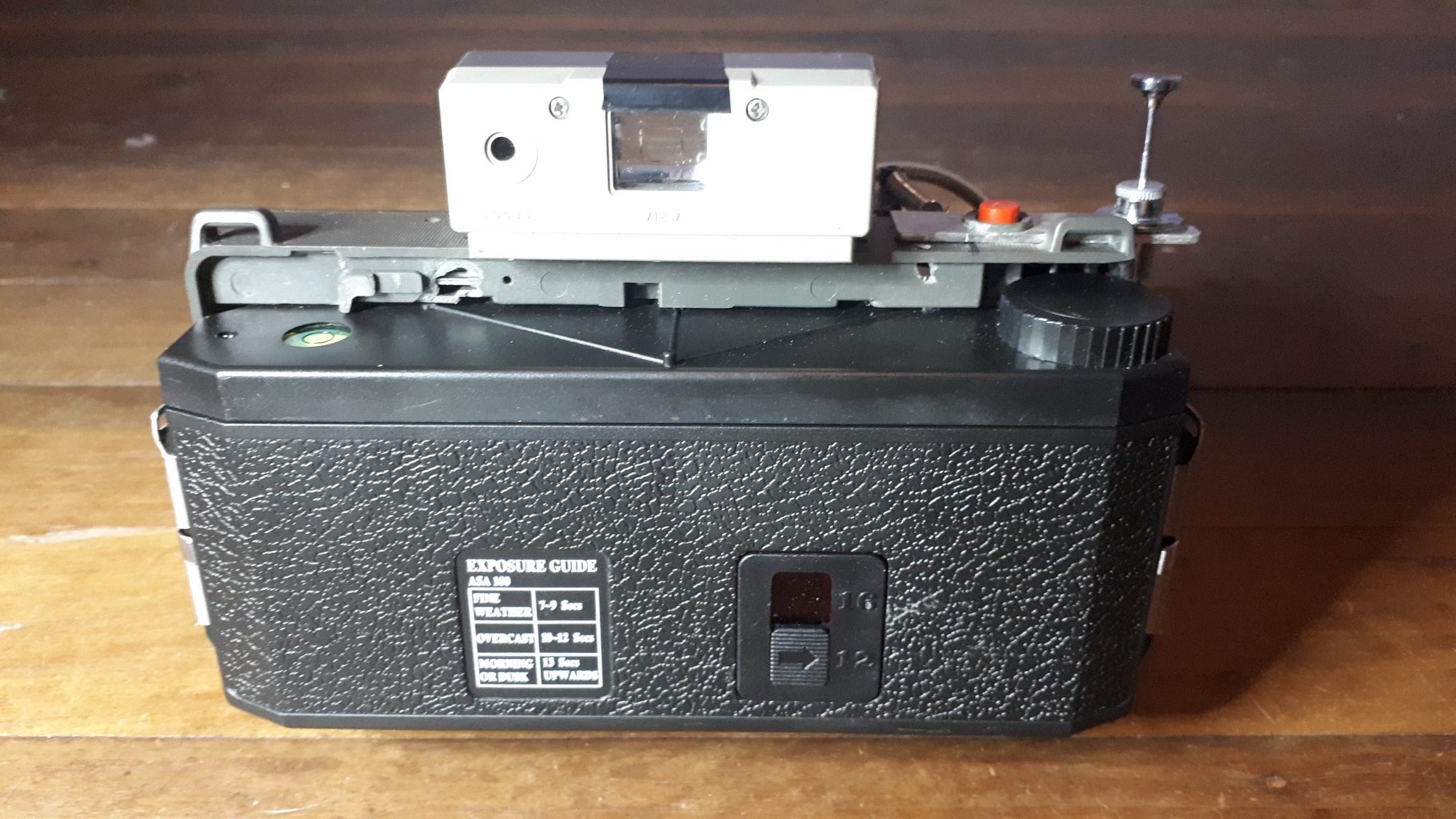

How do I do this? I have a 104 Land that is done for. I have no more peel apart film.
Yes - need more information on this! Methinks some 4x5 direct positive paper would be good in something like this.
I fitted a holga 6x12 pinhole camera to the back to take roll film. It will also do 6x9.
There was a bit of cutting and grinding with a Dremel to get it to fit and a bit of experimentation to get infinity and everything in the right place. If you look at my Flickr account you will see the results. You could make a 4x5 but it wont quite cover.
I will make another for 120mm lens.
Cholentpot
Oct 26, 2015
6,655
So you dremeled open the pinhole and just jammed the whole unit into the back of the Land Cam? Looking at the other photo it looks like the camera is set to infinity permanently? So you can't focus the thing...
I unscrewed the pinhole front and cut out the mask on the Holga, so not to impede the image. I used a focus screen from one of my medium format cameras to work out infinity, I fixed a piece of aluminium to the front standard and installed some springs to hold the front standard at infinity, Its no fixed, I can slide Polaroid focus to push the front standard forwards. It moves it about 1cm which on that lens will go from infinity to about 1.2mtrs, I can move it further out for close focus. If I wanted to I could make a rule and mark out the distance to zone focus, but at f22 or further stop down focus isnt critical, specially for tripod work. The range finder on the camera wont be accurate. If you were to use the original Polaroid lens or something with similar focal length then you might be able to use the cameras range finder. Its a very cheap way to make a 6x12 camera that is quite light and usable. If I make another I can take some photos of the process, but its not very difficult. There are other ways and other cameras you can convert, this is just what I came up with. The Polaroid cost me $20 Australian, the Holga cost $110 AU and lens was $200 AU cheap for a 612 camera with a non plastic lens.
Cool. Thanks for the info.
