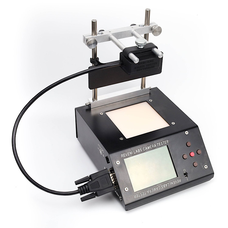

The Reveni Labs Camera Tester is a newly developed camera tester that automatically checks all relevant parameters such as shutter speed, aperture or shutter release.
The device is designed for 35mm film as standard and can be expanded to medium format.
The Reveni Camera Labs tester works digitally and uses LEDs as a test light source.
In contrast to previous models, the tester is small and light and can therefore also be used in a mobile workshop like mine.
Details and specifications can be found on the Canadian manufacturer’s website:
With a retail price of USD 475, the Reveni Labs tester is also within the reach of private users.

Today I set up the Reveni Labs Camera Tester and had my first experiences with it with some of my SLRs.
Here I show some impressions of the assembly and the shutter speed test on a Minolta X-500 in manual mode.
This is the first time I've worked with a camera tester and I only know theoretically how a horizontal focal plane shutter works.
So I'm reporting here from the perspective of a novice 🙂
Assembly quick and easy
The Reveni Labs Camera Tester only needs to be assembled once. No extra tools are required, two keys are included.
I had no problems assembling it and it was quick. The user manual guides you through the steps:
Parts unpacked.
The included switching power supply provides the tester with 12 volt output voltage and can be connected to the mains voltage in Austria (230 volts). The appropriate plug adapter is included.
All parts are cleanly manufactured and fit.
Attaching the light shield.
Fixing one of the two guide rods for the sensor.
The sensor for the 35mm format with its total of six measuring cells.
The device is installed and ready for use.
