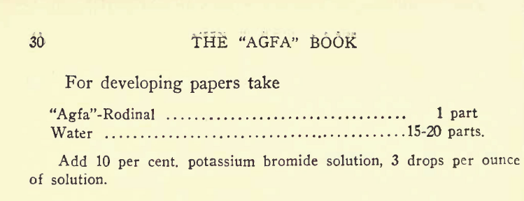

Rodinal was recommended as a Paper developer, as well as for plates and films, some years ago. If I can find the Agfa book I'll give the dilution,
Ilford Certinal was also used as a paper developer, as were other Rodinal clones like Kodinol.
On that basis para-Rodinal should work. Essentially using Paracetamol (Tylenol) as the developing agent. Again you would need to add Bromide.
Ian
