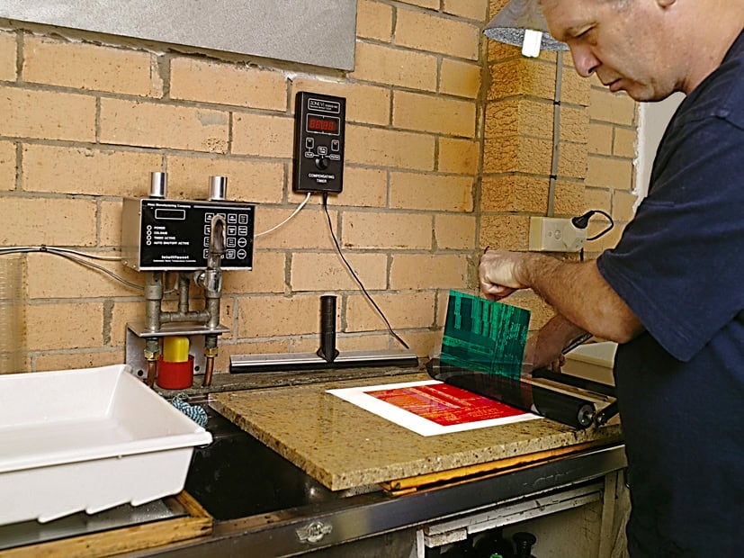

My good friend Andy Cross continues to produce dye transfer prints in Brisbane, Australia. I have several of his prints in my collection. Andy also teaches the process
in a workshop context or to students on an individual basis.
