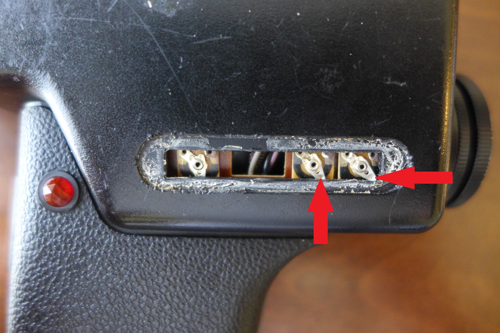

I got the side piece off. I want to wait until I get a gray card and adjust it again before I put the cover back on. I don't know if I am calibrating it wrong, or if the Zone VI mod affects it, but it seems to underexpose a little indoors compared to outdoors. I am posting a picture here in case Google brings someone else to this thread who is looking to adjust the Soligor. I wasn't sure what part I was supposed to be adjusting in the pots because mine were pretty stiff at first, but the little metal tabs are what are supposed to move around the center of the pot. See below:

The first article I sent you was not very specific about the function of the 3 pots in the calibration procedure. Here is a much better description:
http://www.film-and-darkroom-user.org.uk/forum/showthread.php?t=8123
GL
PERFECT, PERFECT, PERFECT!! That was it! Thank you, Arvee! And thanks to that guy who wrote that post.
Basically, the middle pot adjusts the sensitivity, and the rightmost pot trims back the high end. So now my meter is adjusted, AND it is consistent with low and high values (it was underexposing indoors). I don't know how he figured out exactly what those pots do, but it is spot on. The only thing I would say is that I ignored the part about the mid-value, because once you adjust the other two, it should be right. And if you change it after that, it is going to affect the high value, anyway.
Now I am golden and ready to go.
