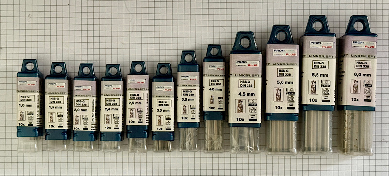

I found this shop in Germany.
Left-handed drills up from 1 mm diameter:
Look for
Spiralbohrer Links
