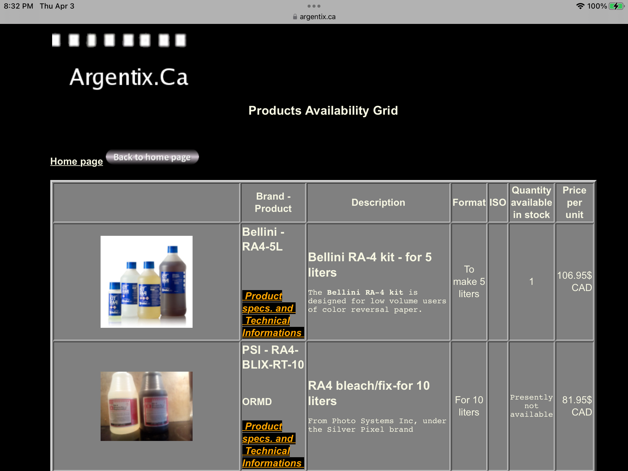

Argentix has the Bellini kit listed right now. The also have the Kodak C41 kit.
The "Silver Pixel" chemicals may be the same or similar to the ones that are currently being brought back/sold under the Kodak label. But that isn't all that clear.
Same manufacturer though.
