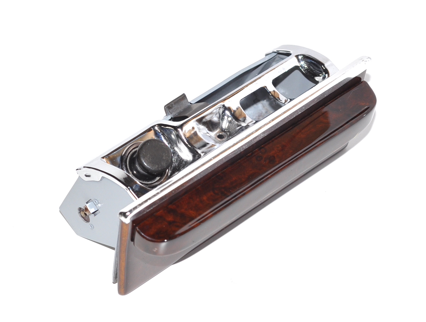

I recently restored the ashtray on my 1986 Mercedes SL. It did not have 90 pieces but there is a tiny lightbulb in there.

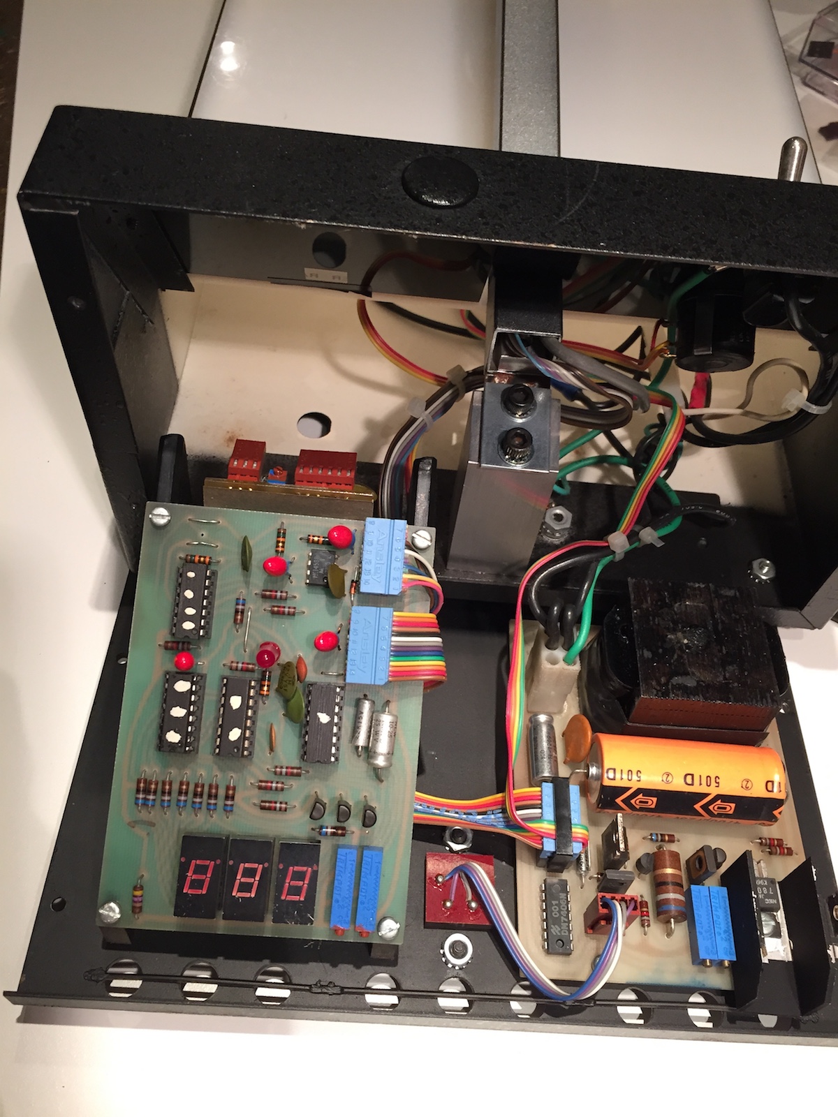

The most common reason old electronics fails is that electrolytic capacitors dry out after 30 or more years.
Thus, you can expect trouble from densitometers and any other electronics made back then.
If you don't know how to replace electrolytic capacitors, I suggest buying a new Printalyzer Densitometer.

Too bad you had to replace your capacitors. Electrolytics are ok in my Tobaias units. Not sure contemporary capacitors last, but old ones do last.
The electrolytic problem dates to the ~1990's - manufacturers of consumer electronics started using cheap Chinese capacitors. Ten years later the world found out why they were so cheap.
Usually anything made after 2010 or before 1980 will have electrolytics with long lifetimes. That doesn't mean cheesy electrolytics weren't available in the 60's & 70's.
If you are going to re-cap the best replacements are probably 105C rated Panasonic/Matsushita capacitors. For the ultimate in lifetime use solid polymer electrolytic caps.
Also ICs with late 1970's date codes can be a problem: The black epoxy that housed the IC was porous and let in moisture; The epoxy was an emitter of alpha particles, causing memory bits to flip; Static protection wasn't in place and so weak partially blown MOS transistors were the norm; And 'purple plague' was endemic where a brittle purple gold/aluminum eutectic would form where tiny gold bond wires were cold-welded to the chip's aluminum pads.
