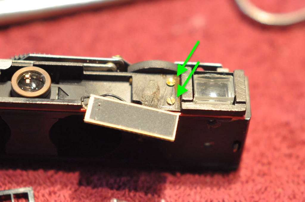

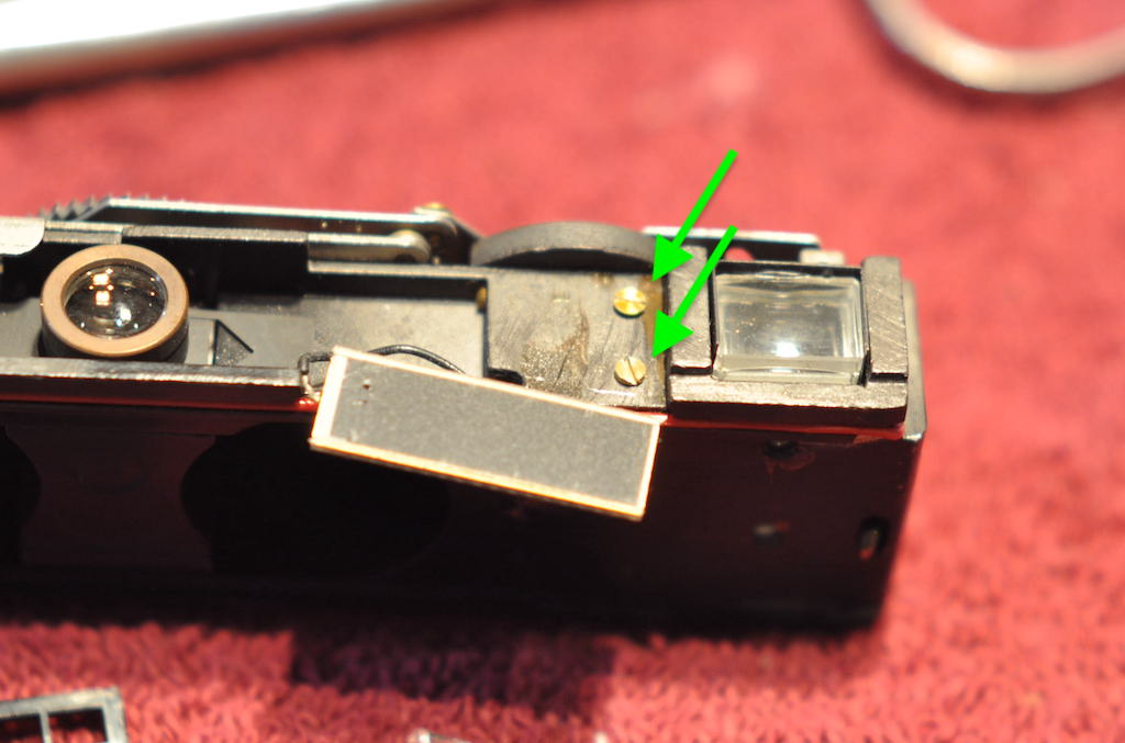

I finally got around to ordering the monocrystalline solar cells in post #21 above. It is almost the same size as the original.
It is a litte too thick for an exact fit (the case tolerances are very small, it won't squeeze in.
ic-racer
ic-racer
Feb 25, 2007
16,483
USA
I unsoldered the black (negative) lead from the existing cell and soldered it to the marked (-) terminal of the new cell. The other end of the cell is marked (+) on the back.
Since the new cell is too thick to fit in the old mount, the old mount will not be used and the cell will just press up against the screws shown when the case is re-affixed to the front of the camera.
ic-racer
ic-racer
Feb 25, 2007
16,483
USA
After installing the mechanism back in the case, the cell is pressed against the brass screws and makes contact. You can see meter is now functional!
