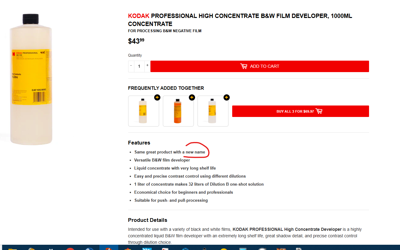

If you check the website for Photo Systems, who are the manufacturer and new holder of the license to distribute and market Kodak branded photo chemicals, you will discover that they are in the midst of retiring the name HC-110:
It will be interesting to see how much resistance they will encounter.
Photo Systems has engaged Cinestill to handle world-wide distribution. Cinestill appears to be trying to find local distribution partners for local markets outside the US.
Here is the link to the Photo Systems site: https://kodak.photosys.com/
Hm, I wonder what that means, perhaps a new developer entirely, seeing they are unable to recreate the original maple syrup one.
Then they can also probably get away from the expectations of a "forever lasting developer", like HC-110 was.
It makes sense though, no hurt feelings here really, I am only miffed that HC-110 (the good old one) will probably never come back.
And this new developer will be interesting to follow for sure, thanks for the link :smile:
