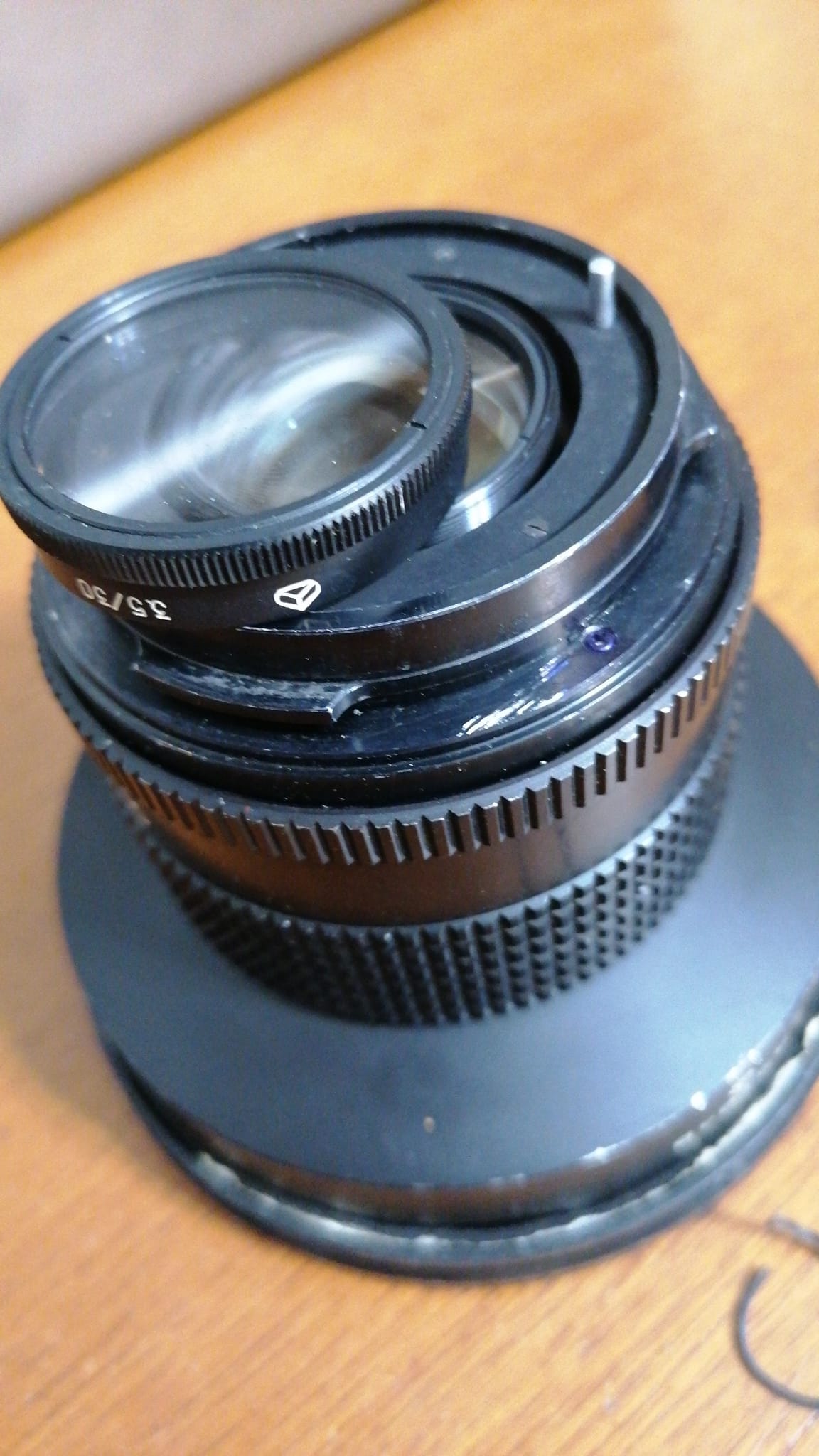

Are you aware of any variation of mounts with the Zodiak 30mm lens?
I ask because I have what appears to be an original Zodiak-8V 3.5/30 Kiev-88, Salut-S Mount lens with the case and 3 rear mount filters in the lid, but the mirror of the Kiev 88 hits the filter when focused at "infinity! If you remove the filter, it just clears.
It is exactly like the one on the Arax page: https://araxfoto.com/lenses/arsat-fisheye/
Infinity is in quotes because you can't reach infinity with the lens mounted; it falls short.
I have also read in various forums that the rear filter is integral to obtaining infinity focus !?!?
Which leads me to believe there are variants of this lens with back-focus differences.
Any ideas?
Any ideas?
The rear filter on the Zodiak/Arsat 30/3.5 fisheye is necessary to achieve infinity focus. Putting a rear filter behind a lens shifts the focal plane back by approximately 1/3 the thickness of the glass in the filter. The filters are just flat glass, no diopter.
If you don't have a clear rear filter, you can sort of bodge a replacement by fitting a small conventional filter (I think the size that would work is 37mm or 39mm) over the rear element and holding it in place somehow. I tried this and it works to achieve focus, but would need to be mounted carefully to avoid hitting the mirror. I don't know why your example has mechanical interference with the Kiev-88 (I have one in Kiev-60 mount and only tried it on a Kiev-60); perhaps the mirror position is just out of tolerance or someone messed with the lens somehow?
For the OP, understand that a Kiev-88 is a camera that looks like a Hasselblad, but not a Hasselblad clone. Personally, although I understand that people have made it work, I think a Kiev-60, Pentacon Six, or Bronica S/S2 would get one started with less aggravation.

Are you sure the transparent filter is missing? It is usually screwed in and apparently not noticeable.
Yes, I am sure. I went back and examined it; I am certain there is no clear rear filter on the lens. I just have the Yellow, Orange and Light Blue filters that are attached to the lens case top.
I think I might have found the issue; the Yellow filter which I placed on the lens initially has some sort of malformed thread that does not allow it to fully seat. After carefully cleaning the threads of all three of the filters, the Light Blue filter fits the best and is almost flush with the end of the lens. The Yellow sits almost one full millimeter above where the blue filter sits.
I will probably remove the filter element from the yellow ring and move it to one of the other rings for now and then try to find a replacement clear filter in the 38x0.5mm size.
"" if you need to use one of the above filters, unscrew the COMPENSATION filter from the back of the lens, WHICH SHOULD ALWAYS BE FITTED, and install the filter you need." (quote)
Many thanks to you both for the suggestions! It caused me to go back and look at the problem with a fresh set of eyes!
I will try a roll and see what transpires. The light blue (80A?) should be fine for either color or b&w until I can find another clear filter.
