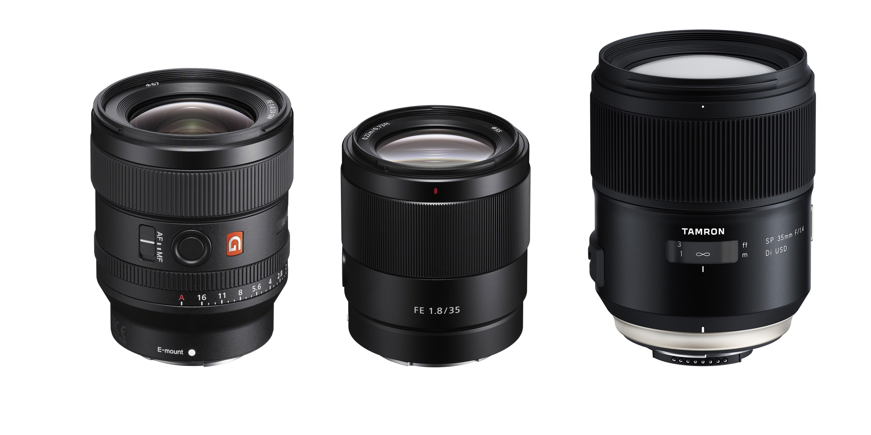

This might be an interesting article for those interested in the original question:
Wether or not it is worth it will depend heavily on a lot of personal factors, like intended use of the image, workflow, budget and muscle strength :smile:
Personally I normally use the Tamron 35 mm F1.8 SP Di VR because I like the image stabilization in low light, the good close up range, and on big scans/prints, it‘s clearly sharper than the 35mm F2 Ai-S lens that I used before.
