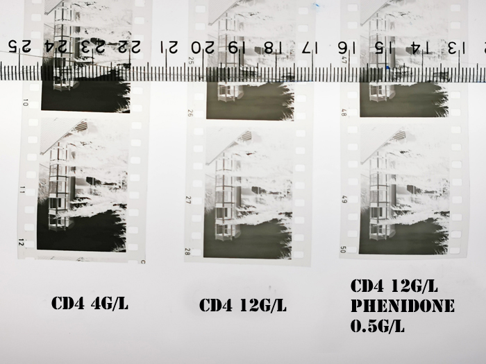

Moersch Finol (In production) and Tetenal Emofin (currently out of production) both used CD-1 as the primary developing agent.
It is the high concentration of CD-4 that causes the contrast reduction [pic].
AFAIK CD-1 at high concentration has never been tried. It would be more toxic by many accounts.

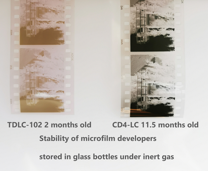

Having found that TDLC-102 gave thinner negatives after about 1 month (using CMS20 II film) I made a test to compare it with CD4-LC 11.5 months old.
Both developers TDLC-102 concentrate and CD4-LC working solution were stored in glass bottles under inert gas.
The results (attachment) show that CD4-LC best meets the requirement of being long lasting.

I have found that use of high concentrations of CD-4 reduces the contrast of microfilms [pic] and the contrast is further reduced by minimal agitation every 3 min.
In combination with reduction of contrast in scanner software this enables some microfilms to be shot at box speed.
The CD-4 oxidation products [pic] probably partially block the silver grain surfaces, their composition is discussed by Weissberger:
