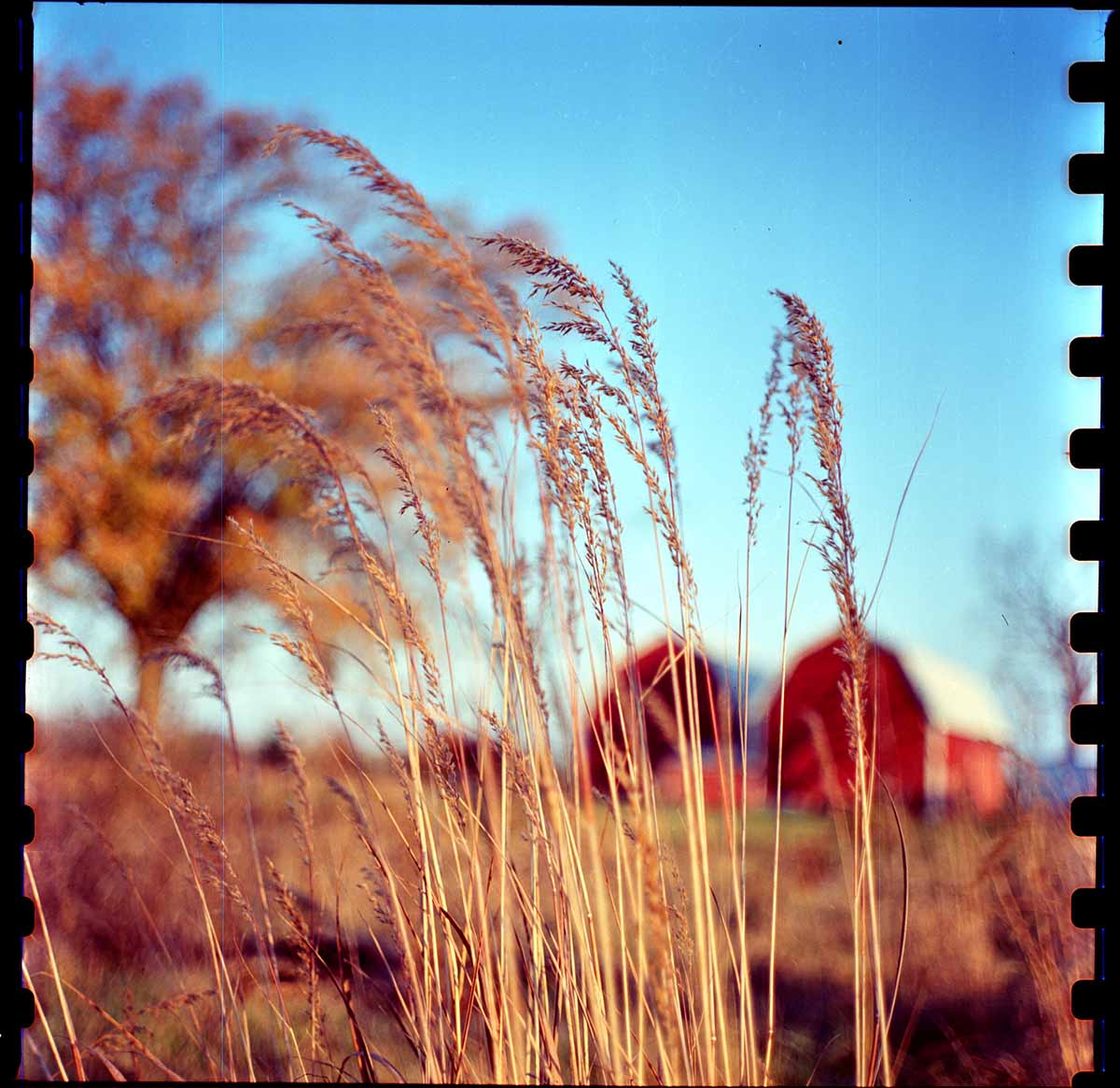

For a unique form of torture, I have built a slitter to cut about 2mm of each edge of 65mm Vision3 250D.
This involved using a contraption with 2 razor blades in total darkness. Totally safe.
There were processed Kodak Flexicolor C41 using Kodak's remjet remover with lye.
I've somewhat built my own little pressure jet washer to spray off the remjet.
I do need to be careful to avoid scratching, when pulling film through the slitter. You also need a 'good pull' to avoid getting into the sprockets, and turning them into pointy little teeth.
While you do shoot into the perfs on both sides, this seems to be bit better than using a sprocket drive 70mm back, where on set of perf is black, and the other is image.
These pics are either from a Bronica s2a w/ 75mm or Lomo LC-A 120
