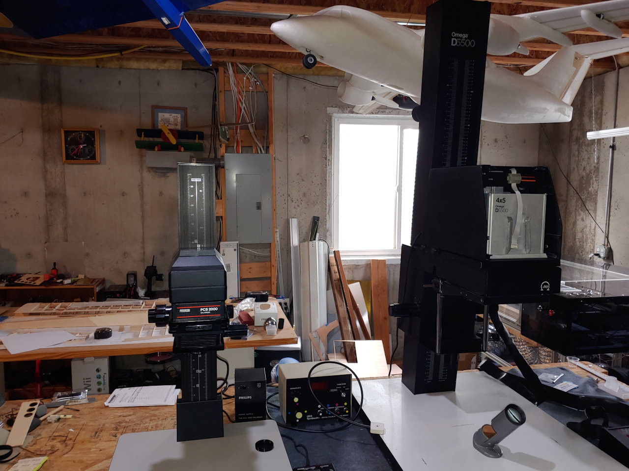

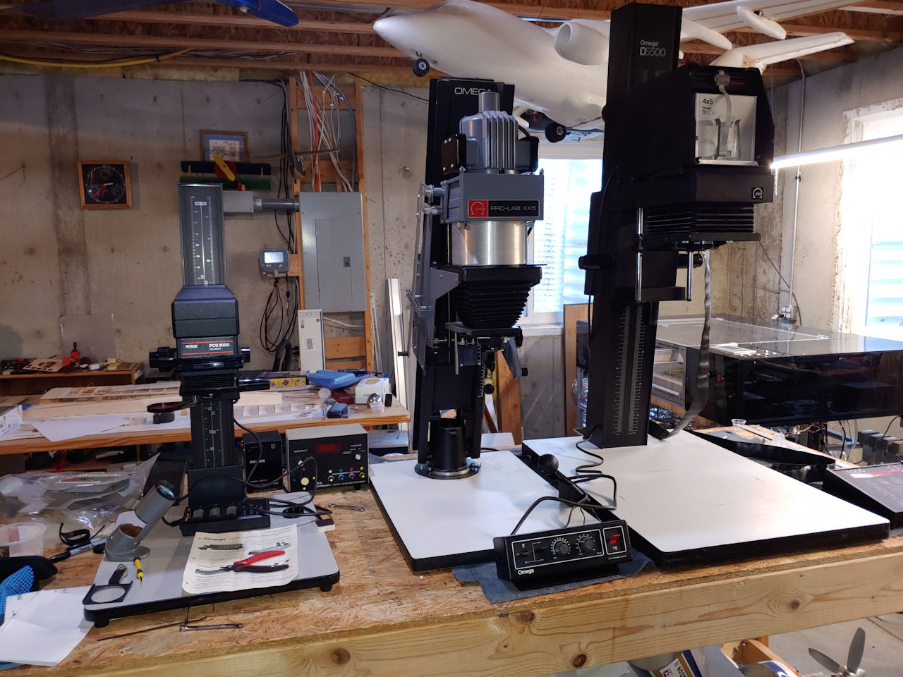

Now with the enlarger chassis all done, I made a quick 4x5 mask just to see how it looks.
It makes my PCS2000 look tiny. My Vivitar VI Dichro is in between
It's tall enough that I need to watch for low flying aircraft.

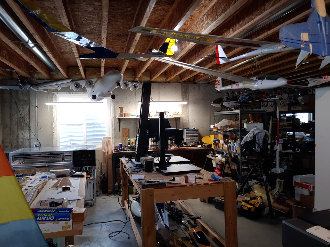

This whole exercise started because I got the itch to do another darkroom. My basement is unfinished and there are rough ins for a bathroom. I'm going to clear out that area and put up a new darkroom. I'm thinking 10x12 feet will do. For the past 18 years or so I have only been doing film and scanning. Want to do a full darkroom one more time.
Looks like a great place for a darkroom! Hopefully no jet exhaust will stir things up. I love my darkroom. In previous homes, I converted half of the lower level, left it open, not ideal. Please continue with updates. :smile:

I added a D5 with a Pro-Lab B&W head. When the darkroom is ready, I will put the D5500 ( assuming it works ) and the D5 in it to start. Don't think I will put all four enlargers I have in there.

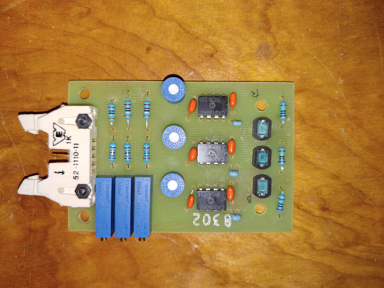

I got my photo cells, they are not the same, actually a little bigger but still fit in the RGB filter housing. I had to drill new holes in the PCB to mount them, but that was easy. What I did find is that they are too sensitive. With the probe gain turned all the way down I would get a no fan error, not sure why that error relates to over driving the photocells. I measured the photo probe output at the A/D input pin for each color and figure anything over 5 or so volts triggers a no fan error.
I made a mask to reduce the light hitting the cells and can now adjust the gain to be in spec. Offset is also fine.. I can now set filtration for each color and the motors dont run on and on. I have a color analyzer, I will set it up with no filtration and then add equal amounts of CYM and see if it tracks.

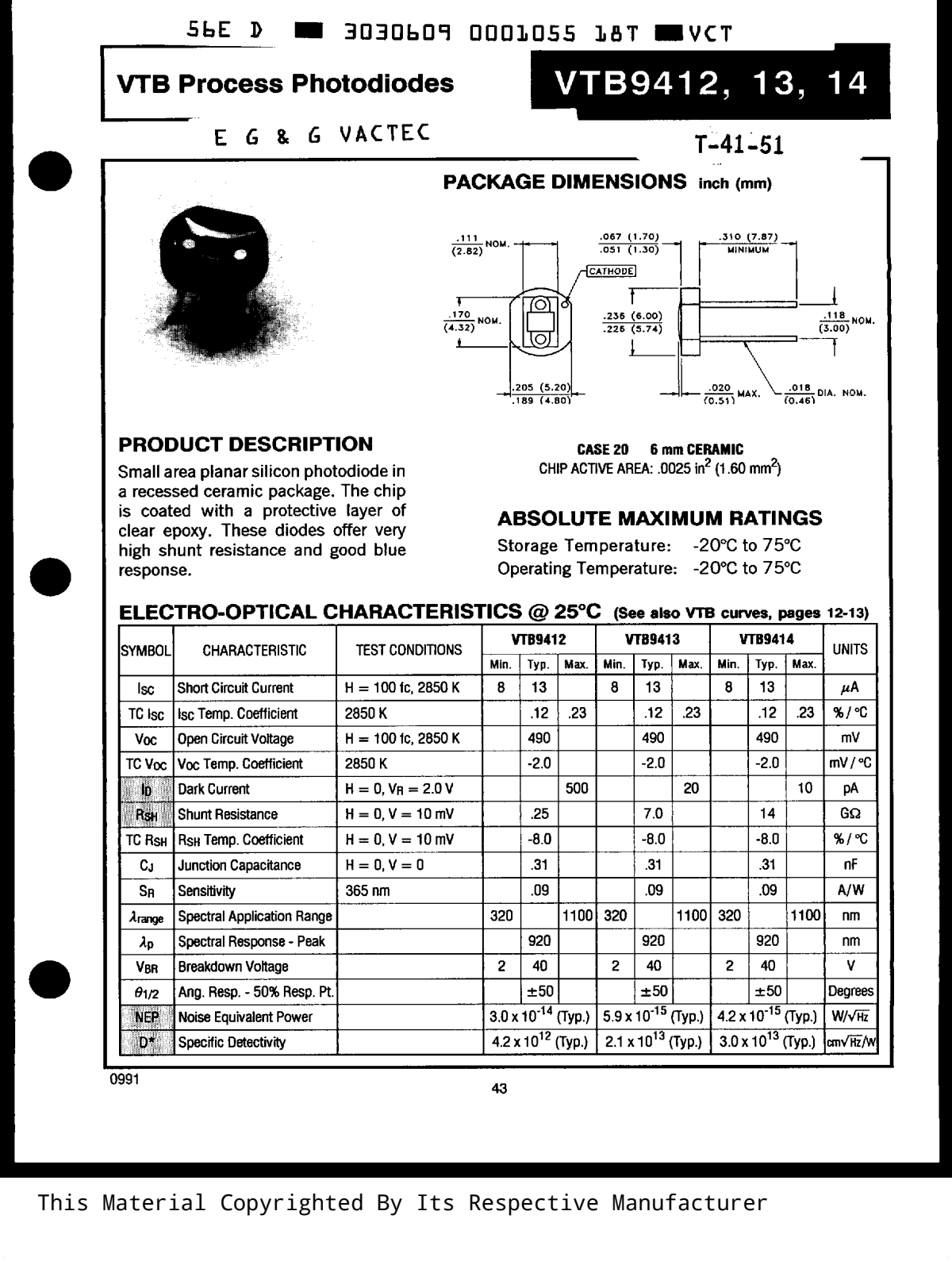

The service manual I got also lists the actual part number for the photocels, VTB9414B. So far I have not found any. What I found and am using are VTB8441BH.
What I will end up doing is re-scaling the gain adjustment on the op-amps so I don't have to use the mask I made
So now I will spend some time convincing myself what I dial in is really what I am getting.

Thanks, I do have that datasheet. The photocells I have coming now are more similar to the 9413B but still much better than what I have at the moment. The active area is also the same as the original, so may not need the mask I'm using now. So for now I'm not going to mess with the circuit and wait till the new photocells are here.

I got my new photodiodes in and installed them. What I learned is that their sensitivity is to low to be useful. I thought about changing the gain in the circuit but decided against.
What else I noticed is that it seems someone replaced the offset pots on my probe, what's in there does not really fit well. The pots seemed really sensitive to adjust, just tapping them changes the setting. I found some 5 turn pots that I will try.
It might all be moot as I have a probe coming, but then what else would I do with my time......... Oh yes, maybe actually go take some photos.

Today I played a little more with my color probe. I put the first batch of photodiodes back in. Instead of using the mask I had, I decided to try something else without changing the circuit ( gain ), I stacked two of each RGB filters in the filter holder. That seemed to work really well. I can still adjust the gain without being at either extreme. The time the motors spend hunting seems to be much less. I get 197-198 on the filtration.
I still find the offset adjustment much too sensitive. Will see what it's like with the 5 turn pots.
I also had the control apart. Made copiers of the two ROMs, just in case.....

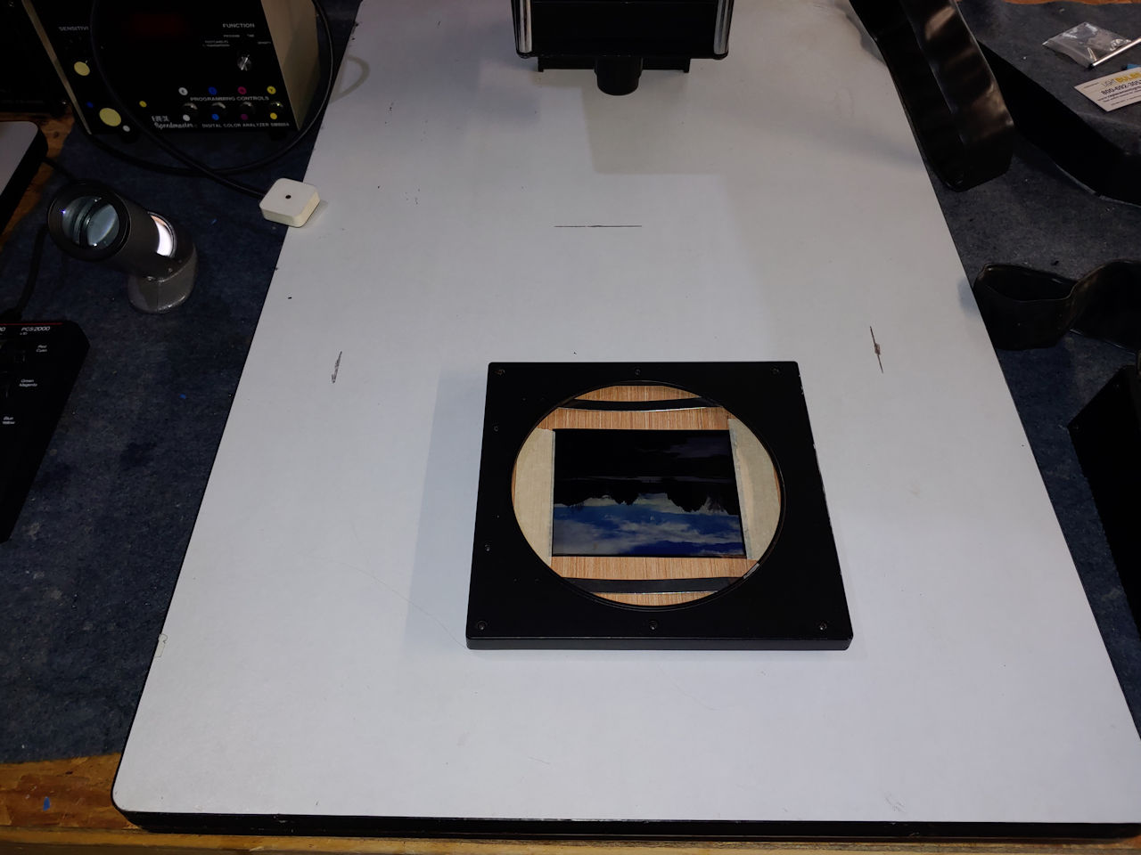

My next task is to make some film holders. I 3D printed one that holds 35mm strip, but I think I will change the design a bit.

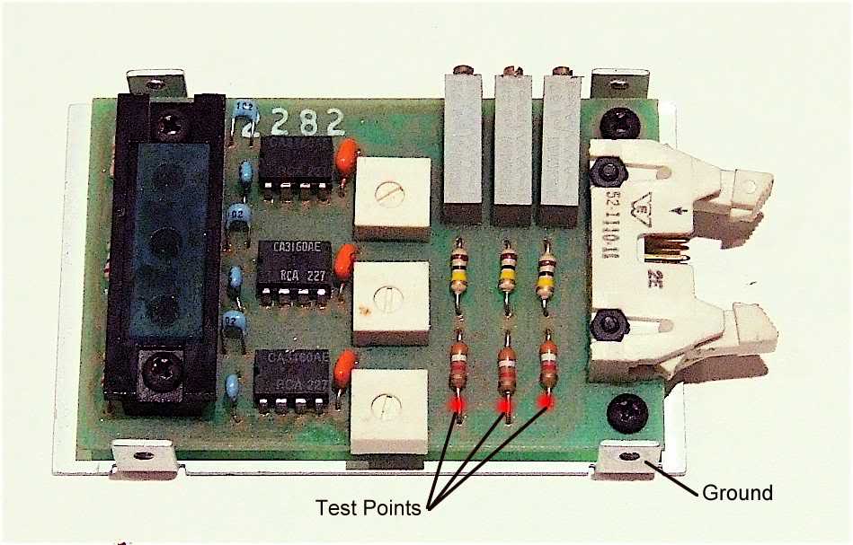

Does your color probe look like this?
Joel_L
Mar 12, 2011
578
Colorado
@ic-racer
Looking at your probe again, the board looks the same but the component values are different. In my service manual, I notice that the component values in the schematic are different from what's in the parts list. When I bought a probe from KHB, Kevin mentioned the probe was updated to the latest spec. There is an update section in my manual, that at least from that update, the schematic is correct. My probe has the old values on it. From your picture, looks like you are at the latest.
