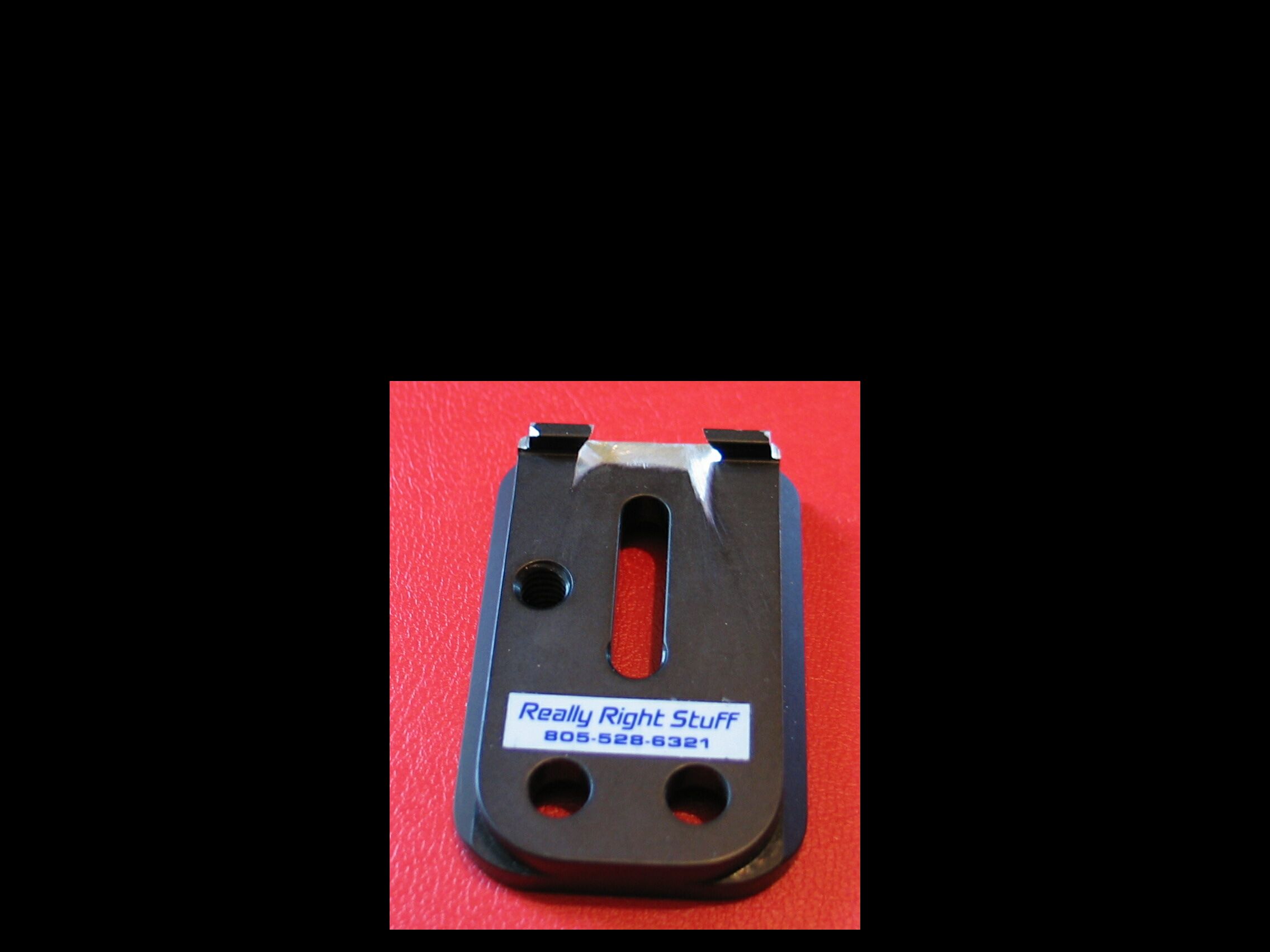

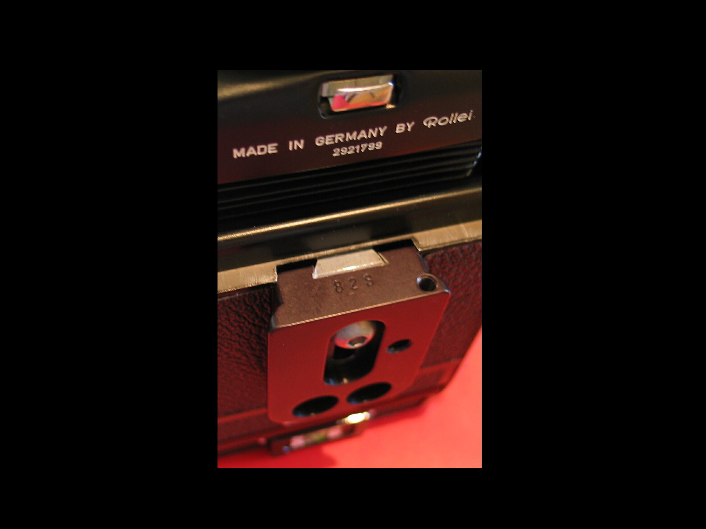

...................... That being said, the focus rack design of the SL66 does make me wonder just how sturdy it really is with heavier lenses (given the known issues with Rolleiflex 2.8s) - the fact that Rollei jumped to regular helicoids with the SLX only a few years after the SL66 was launched also raises a few questions in my mind.
The rigidity of the SL66 could be a problem with heavy or long lenses. I noticed that there is some small but possibly significant movement using the Rollei camera mount, the one that slots into the wedge shaped cutouts on the base. Instead of that, I use a hand filed larger plate that supports part of the base as well as the fitting. On a tripod it is a bit more stable. The wedge shaped cut at the front was filed delicately so that it's a tight fit as the plate is slid back to position.
